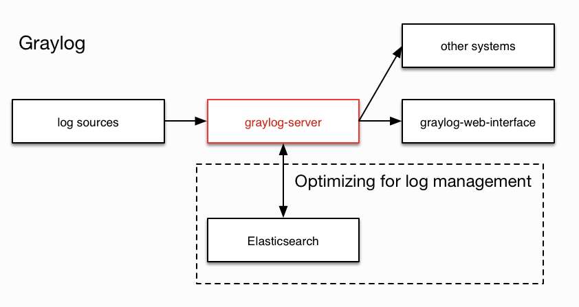

Since not all devices follow the same logging format, it is impossible to develop a universal parser. For devices that don’t comply with Syslog format rules, Graylog overrides this issue using pipelines and extractors. Log file parsing is done by a combination of raw/plaintext message inputs, extractors, and pipeline processors. The built-in raw/plaintext inputs allow you to parse any text that you can send via TCP or UDP. No parsing is applied at all by default until you build your own parser. Let’s discuss what extractors are and why they were created in the first place.
EXTRACTORS
Syslog (RFC3164, RFC5424) has been a standard logging protocol since the 1980s, but it comes with some shortcomings. Syslog has a clear set of rules in its RFCs that define how a log should look like. Unfortunately, there are a lot of devices such as routers and firewalls that create logs similar to Syslog but non-compliant with its RFC rules. For example, some use localized time zone names or omit the current year from the timestamp, which causes wrong or failed parsing.
One possible solution was to have a custom message input and parser for every format that differs from Syslog, which would mean thousands of parsers. Graylog decided to address this problem by introducing the concept of Extractors in the v0.20.0 series.
The extractors allow users to instruct Graylog nodes about how to extract data from any text in the received message (no matter which format or if an already extracted field) to message fields. This allows for more elaborate queries like searching for all blocked packages of a given source IP or all internal server errors triggered by a specific user.
You can create extractors via Graylog REST API calls or via the web interface using a wizard.
PIPELINE PROCESSORS
Pipeline Processors are the preferred method of parsing logs flowing into Graylog allowing for greater flexibility in routing and enriching a message before writing to disk. Pipeline processors can be used to call external functions line Geo-Location or Lookup tables to add additional context around data at ingestion time.
Pipelines are a set of rules grouped in stages, allowing a message to flow through each stage for processing. Each pipeline can be set to multiple streams of data to allow for great control of the processing each log gets.

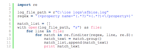

You can create a custom log file in Python by using regex. This is an example of parsing by line.
Open instruction opens the defined log file path using read-only access (“r”) and assigns the data to the file variable. The for loop goes through the data line by line, and if the text in line matches regex, it gets assigned to the match variable as an object.

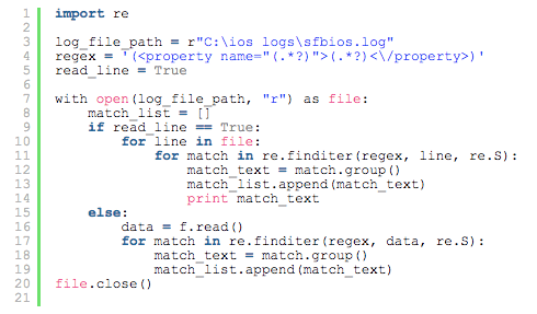

To parse more than one line at a time, you can assign the whole file’s data to a variable using data = f.read().
In this example, you can choose whether to parse by line (if read_line is True) or by file (if read_line is False). The matching algorithm is the same, with the only difference in the data that is compared with regex (line or whole text).
