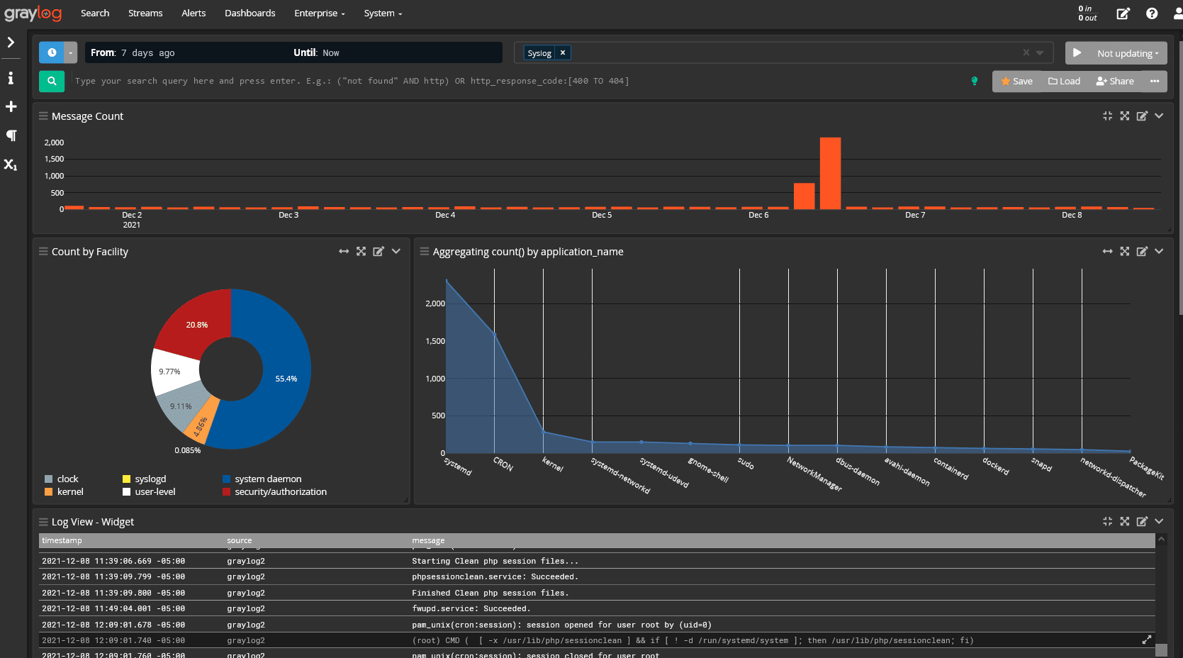

Jan 09 19:00:01 localhost graylog-router: *Jan 10 13:58:40.411: %SYS-5-CONFIG_I: Configured from console by console
Jan 09 19:00:01 localhost graylog-router: *Jan 10 13:58:46.411: %SYS-6-LOGGINGHOST_STARTSTOP: Logging to host 192.168.1.239 stopped – CLI initiated
Jan 09 19:00:01 localhost graylog-router: *Jan 10 13:58:46.411: %SYSMGR-STANDBY-3-SHUTDOWN_START: The System Manager has started the shutdown procedure.
Jan 09 19:00:01 localhost graylog-router: *Jan 10 13:58:46.411: %SYS-6-LOGGINGHOST_STARTSTOP: Logging to host 192.168.1.239 started – CLI initiated
Jan 09 19:00:01 localhost 0.0.0.0: *Jan 10 13:59:12.491: %SYS-5-CONFIG_I: Configured from console by console
