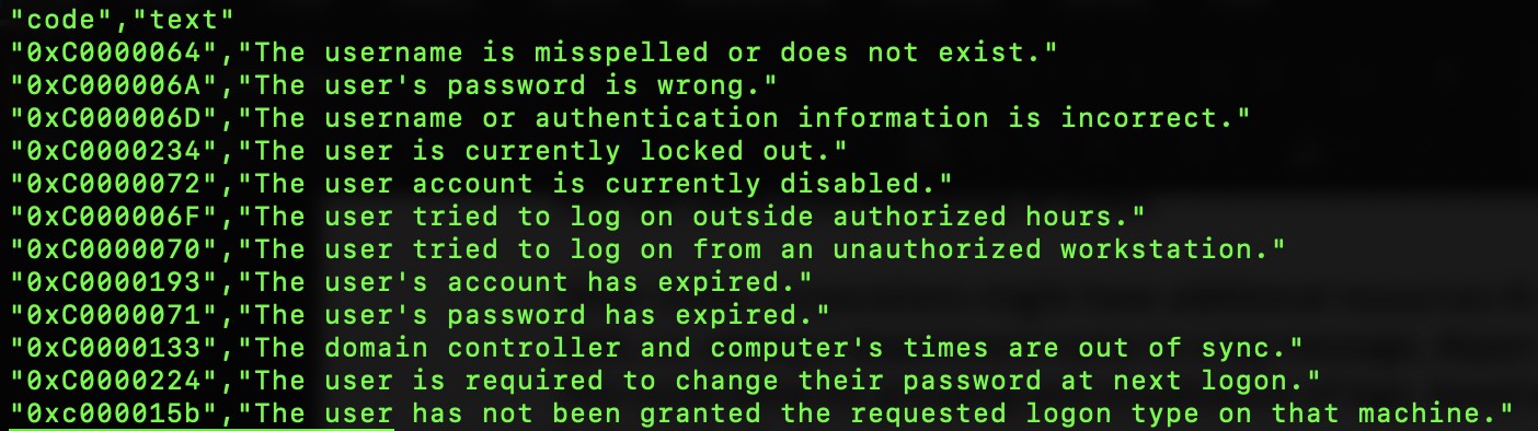

In this example, the file contents look like this:

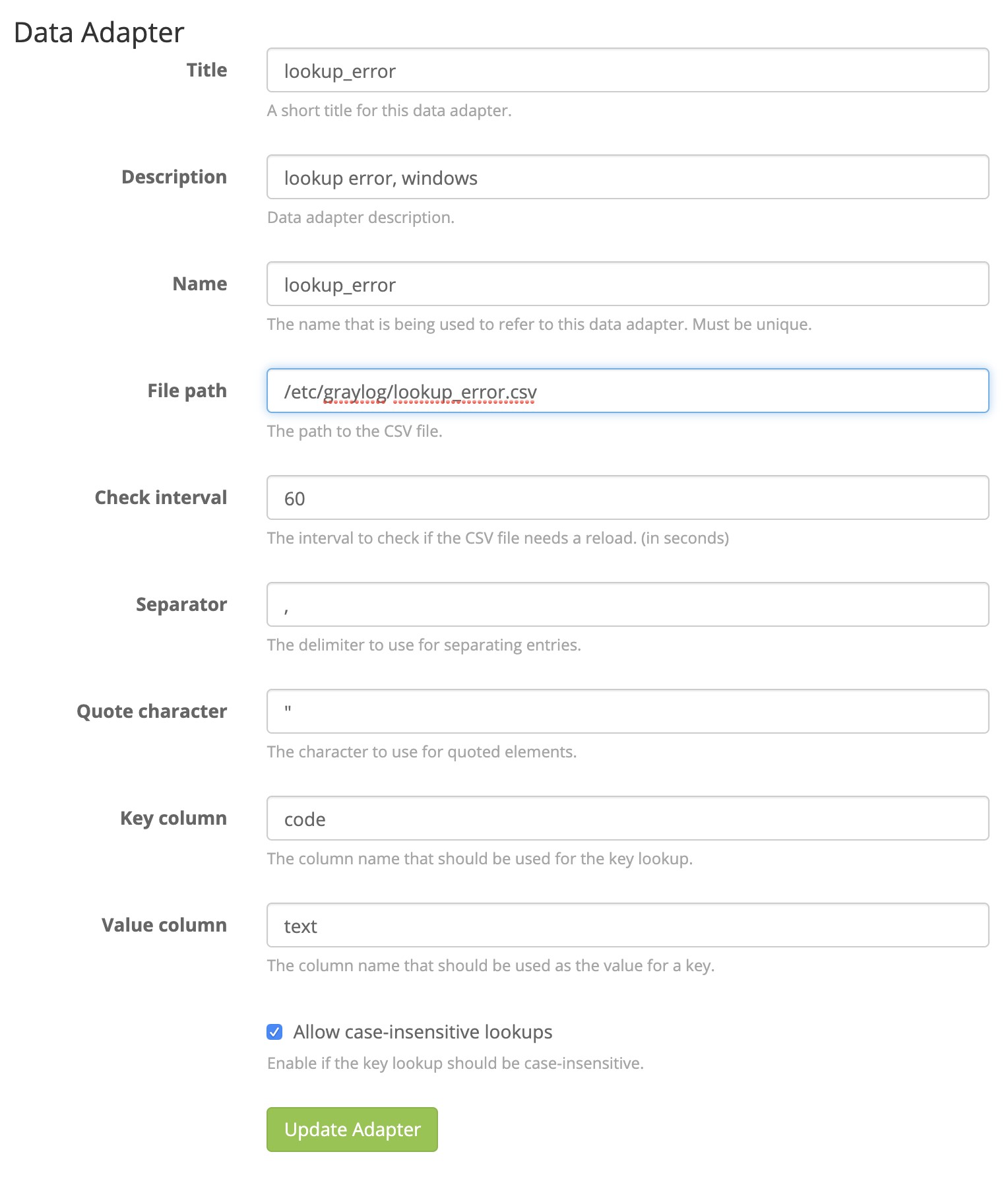

Now we need to configure the Lookup Table to read the CSV when an input is given to it.  We will first create the data adapter under System -> Lookup Tables and Select “Data Adapters.”  On this page, select “Create data adapter,” and fill in one like below:

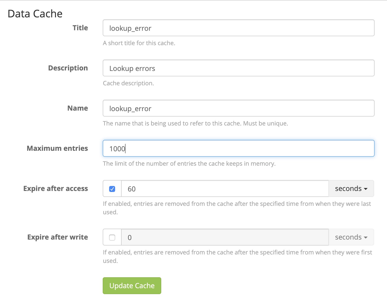

Next, we need to create a Cache with the “Create cache” button like below:

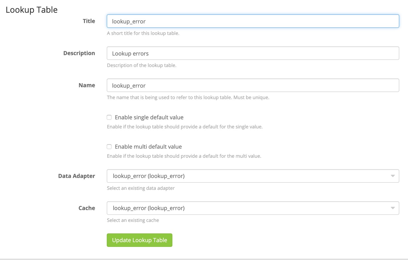

In the last step in the Lookup Table, we need to create the table itself, using the created data adapter and cache from the last two steps:

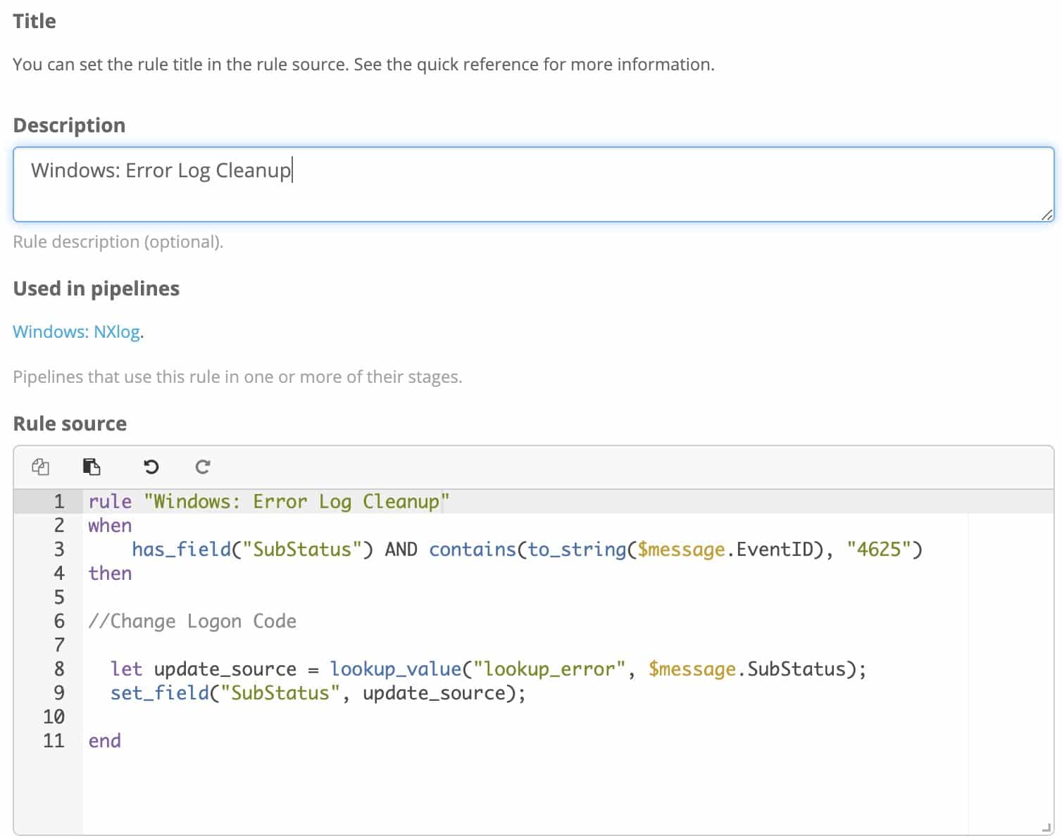

Now that the lookup table has been created and ready for use, we need to create a pipeline rule to utilize it and add in the metadata to each message with an IP address.

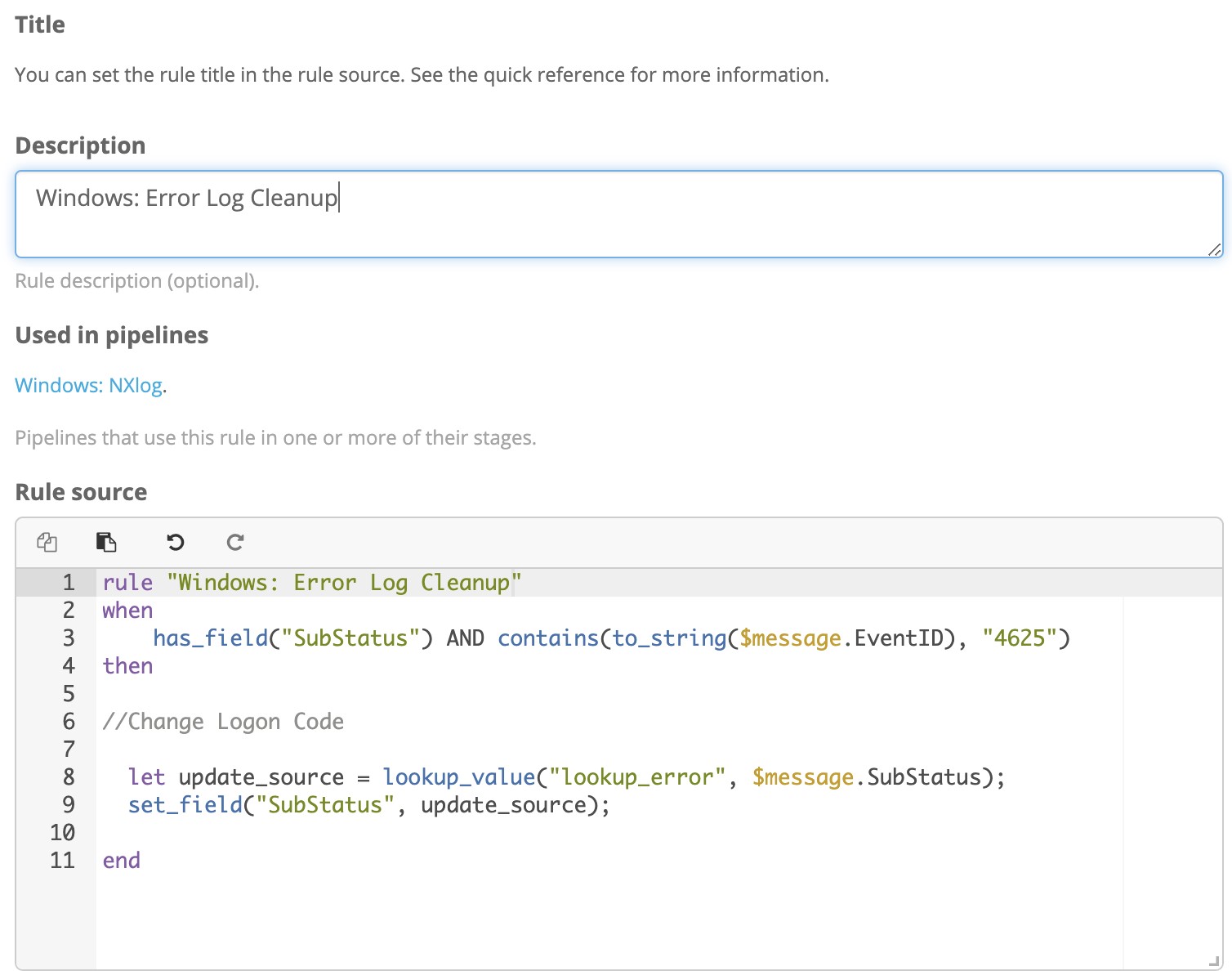

Go to (System -> Pipelines) and under the “Manage rules,” we will need to create a new rule.  Give it a description so you can remember it, and in the Rule Source put:
rule “Windows: Error Log Cleanup”
when
    has_field(“SubStatus”) AND contains(to_string($message.EventID), “4625”)
then
//Change Logon Code
  let update_source = lookup_value(“lookup_error”, $message.SubStatus);
  set_field(“SubStatus”, update_source);
end
The when condition is only allowing the rule to process when the log has the field SubStatus and has the EventID of 4625. NOTE: Please change this to the field name containing your SubStatus and EventID, as they can be different names. Once it finds those logs, it runs the lookup against our Lookup Table “lookup_error” with the data in the SubStatus field, then changes SubStatus to something more understandable.

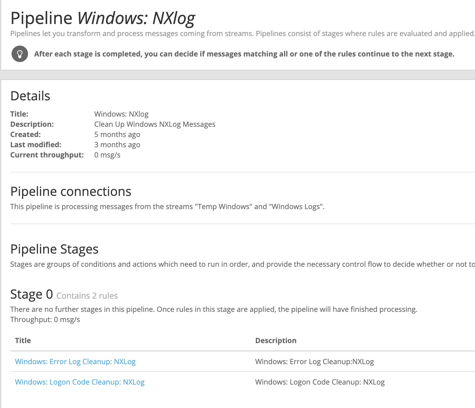

Once the rules are created, add them to a stage in the pipeline processing the logs with an IP address in them, and the enrichment will start working.

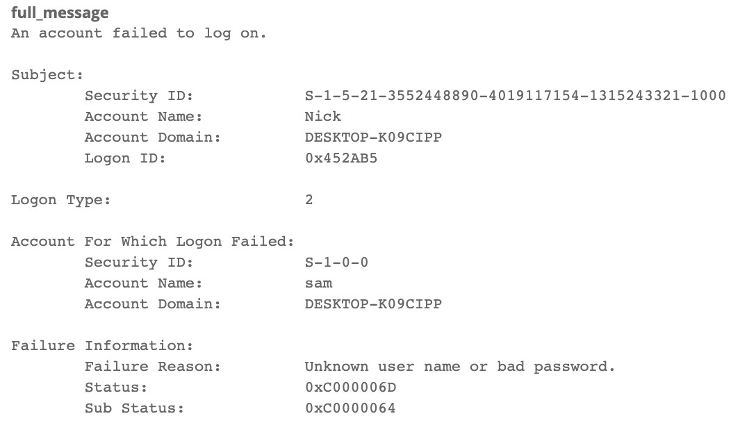

And once new logs will come through the pipeline, you can see the enriched log entry:
The original log will still contain the Hex code as shown:
