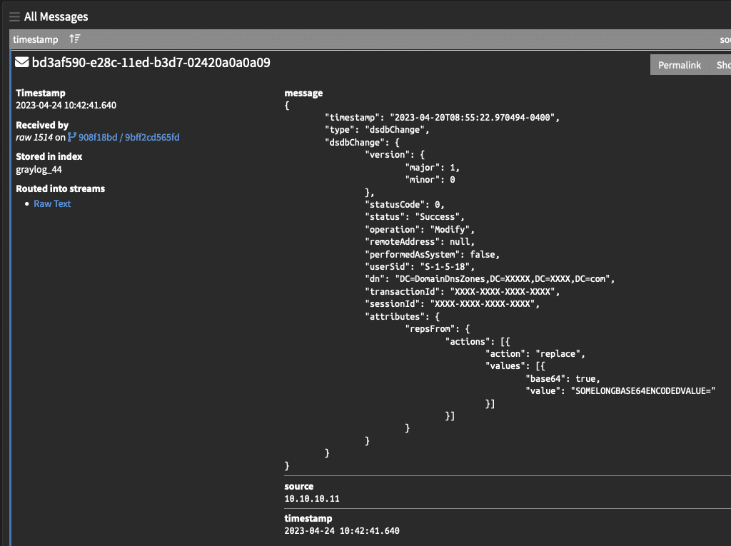

3. Look for JSON Format
JSON formatted messages are easily recognized from their structured organization of brackets and commas. JSON logs work nicely with Graylog, since the format provides not only the values but also the field names. Graylog can parse JSON format logs very simply using JSON flattening, which is detailed in the Graylog documentation here.
If we take the below JSON message as an example:
   "type": "dsdbChange",
   "dsdbChange": {
       "version": {
           "major": 1,
           "minor": 0
       "statusCode": 0,
       "status": "Success",
       "operation": "Modify",
       "remoteAddress": null,
       "performedAsSystem": false,
       "userSid": "S-1-5-18",
       "dn": "DC=DomainDnsZones,DC=XXXXX,DC=XXXX,DC=com",
       "transactionId": "XXXX-XXXX-XXXX-XXXX",
       "sessionId": "XXXX-XXXX-XXXX-XXXX",
       "attributes": {
           "repsFrom": {
               "actions": [{
                   "action": "replace",
                   "values": [{
                       "base64": true,
                       "value": "SOMELONGBASE64ENCODEDVALUE"

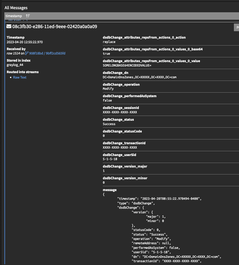

We can parse this effortlessly with a generic JSON parsing Pipeline Rule, below:
rule "JSON FLATTEN"
when
   true
then
   let MyJson = flatten_json(value: to_string($message.message), array_handler: "flatten", stringify: false);
   set_fields(to_map(MyJson));
end
This will parse all the fields out of the JSON structure, fire and forget.

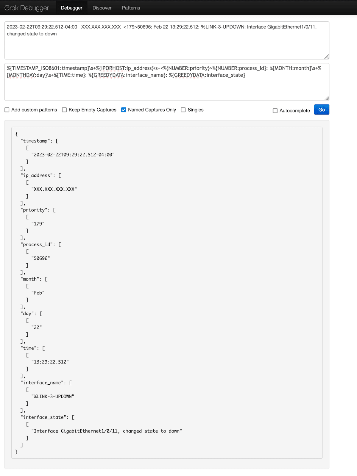

4. Look for a consistent format for Grok
OK, so your logs don’t follow a format that Graylog can parse out-of-the-box, are not consistently delimited, are not set up in key value pairs, are not in a JSON format. But the format is at least consistent, even if the way the fields are broken up maybe isn’t. There is a structure here that we can parse using Grok. For example, the message:
2023-02-22T09:29:22.512-04:00   XXX.XXX.XXX.XXX  <179>50696: Feb 22 13:29:22.512: %LINK-3-UPDOWN: Interface GigabitEthernet1/0/11, changed state to down
This log format is all over the place with delimitation of fields, but there is still a consistent pattern of fields we can see: timestamp, ip_address, priority, process_id, event_timestamp, interface_name, interface_state. In this situation, the easiest way to extract these fields is to use Grok. You can read more about using Grok within a Pipeline Rule in the Graylog documentation here.
Grok might look a bit intimidating, but it’s actually pretty easy once you get started. Online Grok de-buggers, such as this one, are your best friend when writing a Grok rule. The key to writing Grok is to focus on capturing one word at a time before trying to capture the next, and to remember that whitespace – including trailing whitespace, which often catches people out – is included in the pattern.
Here is the Grok to parse this message:
%{TIMESTAMP_ISO8601:timestamp}\s+%{IPORHOST:ip_address}\s+<%{NUMBER:priority}>%{NUMBER:process_id}: %{MONTH:month}\s+%{MONTHDAY:day}\s+%{TIME:time}: %{GREEDYDATA:interface_name}: %{GREEDYDATA:interface_state}
Seen here in the Grok debugger https://grokdebugger.com/ in which it was written:
Once you have a Grok pattern that works – and check it against multiple examples of the log message, not just on one, to make sure it works consistently – the next step is to convert your Grok pattern into a Graylog Pipeline Rule. Note that all escape characters within your Grok string need to be prefaced with a \, including “\”.
Here is the pipeline rule for parsing the message field using this Grok rule:

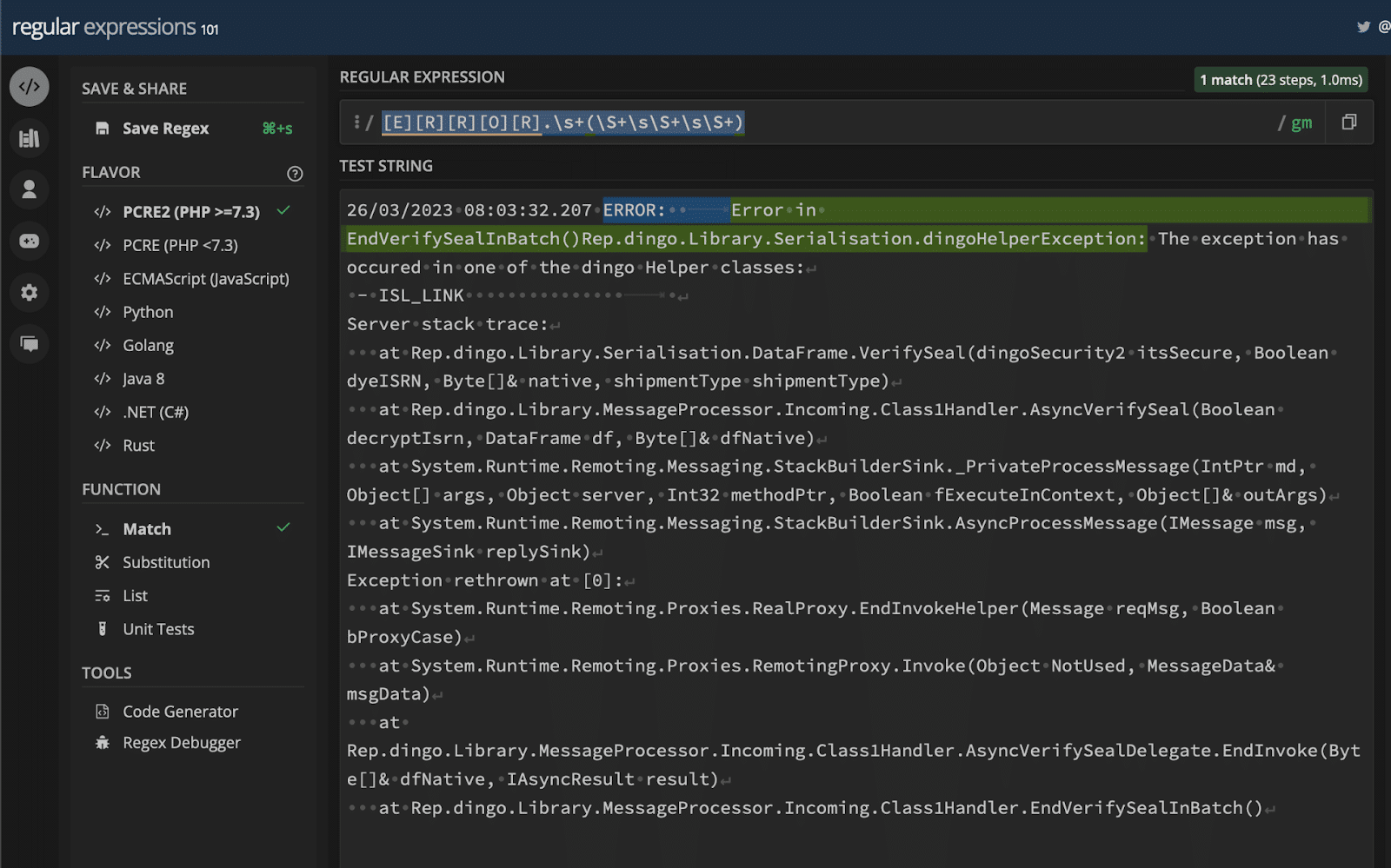

5. Nothing is consistent? Time for Regex
If the field you need to extract from your data is really inconsistently placed, and none of these techniques are useful, then it’s probably time to write some Regex.
Regex can be used in Pipeline Rules much the same as Grok, though it is better suited to scalpelling out a single tricky field than trying to parse a whole message into fields. There is a Graylog Documentation page on using Regex in Pipeline Rules here. Regex is especially useful when capturing errors or stacktraces, which can blow out to many lines of text and otherwise confuse your parsers.
26/03/2023 08:03:32.207 ERROR:  Error in EndVerifySealInBatch()Rep.dingo.Library.Serialisation.dingoHelperException: The exception has occured in one of the dingo Helper classes: ISL_LINK
Server stack trace:
   at Rep.dingo.Library.Serialisation.DataFrame.VerifySeal(dingoSecurity2 itsSecure, Boolean dyeISRN, Byte[]& native, shipmentType shipmentType)
   at Rep.dingo.Library.MessageProcessor.Incoming.Class1Handler.AsyncVerifySeal(Boolean decryptIsrn, DataFrame df, Byte[]& dfNative)
   at System.Runtime.Remoting.Messaging.StackBuilderSink._PrivateProcessMessage(IntPtr md, Object[] args, Object server, Int32 methodPtr, Boolean fExecuteInContext, Object[]& outArgs)
   at System.Runtime.Remoting.Messaging.StackBuilderSink.AsyncProcessMessage(IMessage msg, IMessageSink replySink)
Exception rethrown at [0]:
   at System.Runtime.Remoting.Proxies.RealProxy.EndInvokeHelper(Message reqMsg, Boolean bProxyCase)
   at System.Runtime.Remoting.Proxies.RemotingProxy.Invoke(Object NotUsed, MessageData& msgData)
   at Rep.dingo.Library.MessageProcessor.Incoming.Class1Handler.AsyncVerifySealDelegate.EndInvoke(Byte[]& dfNative, IAsyncResult result)
   at Rep.dingo.Library.MessageProcessor.Incoming.Class1Handler.EndVerifySealInBatch()
If you want to capture the first 3 words after the first occurrence of “ERROR” in your log message, you could use a Regex rule.
We would highly recommend the free online Regex tool available at https://regex101.com/ for the purposes of composing your Regex.
In this example, the Regex rule would be: [E][R][R][O][R].\s+(\S+\s\S+\s\S+)
This would capture the value “Error in EndVerifySealInBatch()Rep.dingo.Library.Serialisation.dingoHelperException:”
Once your Regex rule is working in https://regex101.com/ then it is time to put it into a Graylog Pipeline Rule. Note that all escape characters within your Regex string need to be prefaced with a \, including “\”.Here is the Pipeline Rule for capturing the first 3 words after the first occurrence of “error” in the message field using this Regex rule:
rule "Regex field extract"
when
true
then
 let MyRegex = regex("[E][R][R][O][R].\\s+(\\S+\\s\\S+\\s\\S+)", to_string($message.message));
 set_field("MyFieldname_1", x["0"]);
end
This rule would create a new field with the current value:
MyFieldname_1: “Error in EndVerifySealInBatch()Rep.dingo.Library.Serialisation.dingoHelperException:”

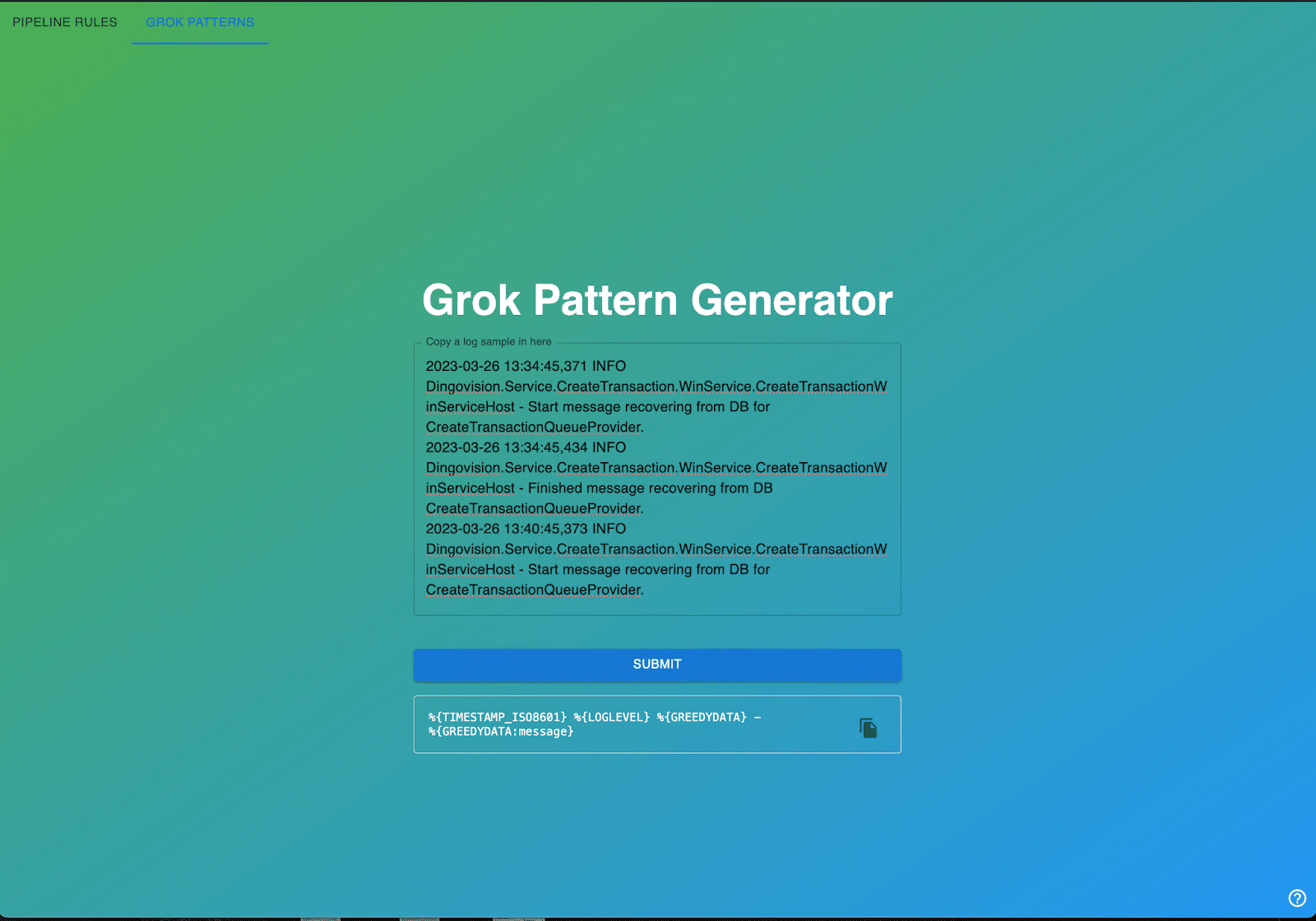

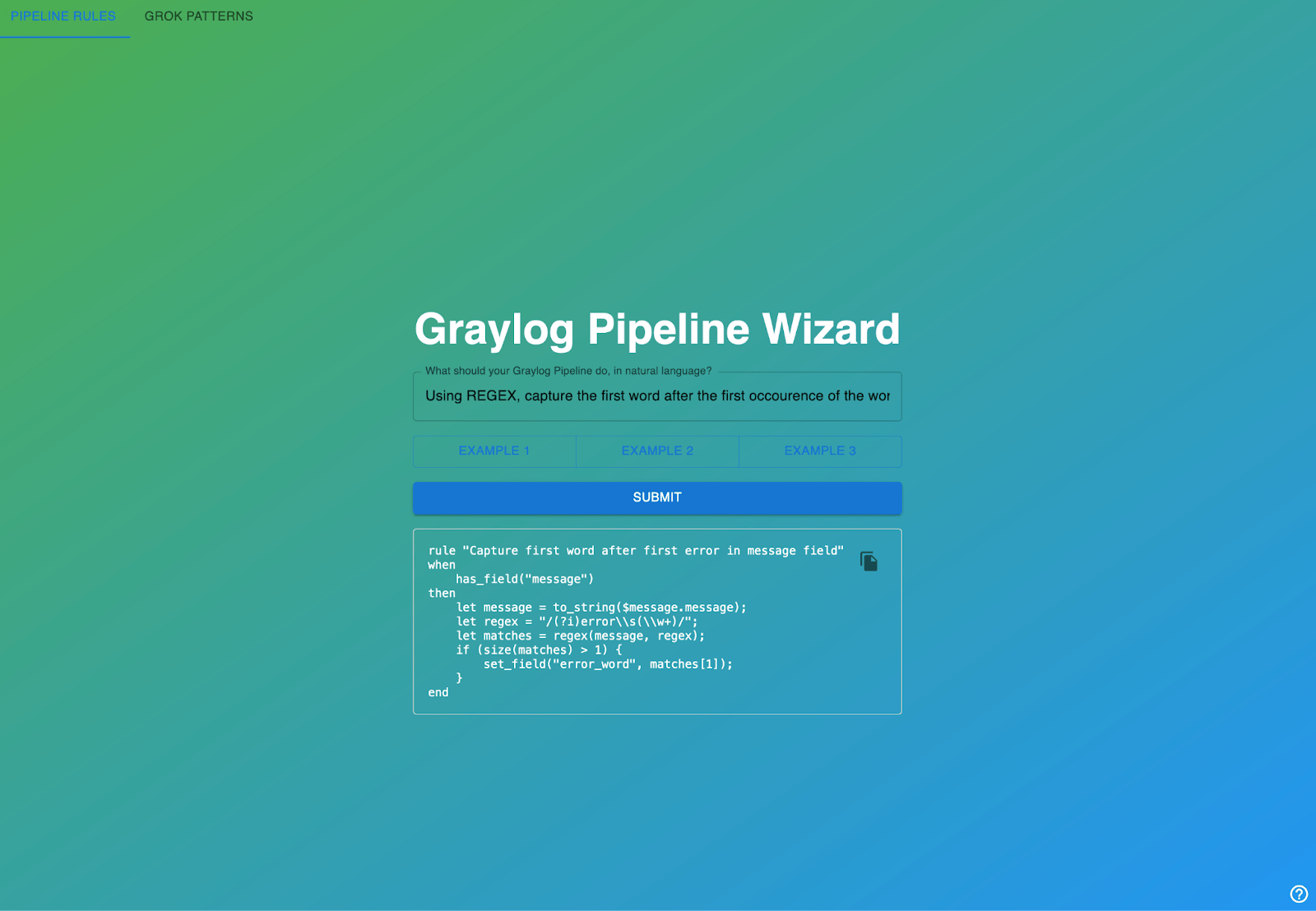

7. Stuck? ChatGPT can write both Graylog Pipeline Rules and GROK/Regex Parsing… sometimes.
Technology is a beautiful thing! ChatGPT, the AI that needs no introduction, can write Graylog Pipeline rules. It can also write GROK or Regex parsers – just paste in your log sample and ask nicely. This is really useful in theory and can often point you in the right direction, but be warned that in practice, the AI will make various mistakes. Rather than entering your requests into ChatGPT directly, we recommend checking out this useful Community tool that leverages OpenAI’s GPT API and an extensive prompt designed to improve results.
https://pipe-dreams.vercel.app/
AI is far from perfect at these tasks at this stage, but still very useful – particularly at showing syntax and structure. Please note the tabs on the top left that switch between Pipeline and GROK parsing modes.
