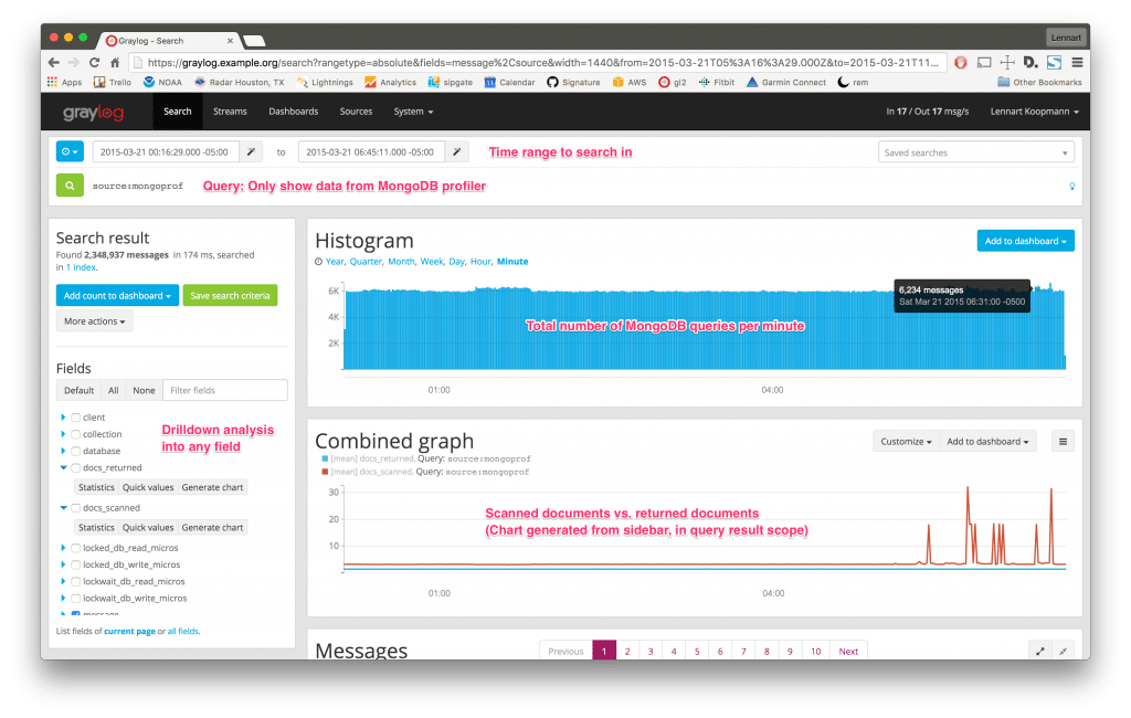

Let’s start by running a Graylog query that shows you all recorded MongoDB queries in a specific time frame:
The Combined Graph chart above shows the number of returned documents vs. the number of scanned documents, which was created on the spot using the Fields sidebar. Looking at the spikes in the Combined Graph chart, we can see that the ratio of scanned vs. returned documents doesn’t appear to be normal.

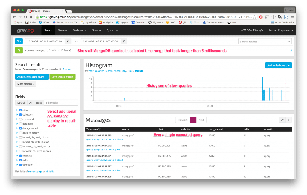

Digging deeper, I extended the search query to only show slow queries (> 5 milliseconds) and found 64 slow queries in the specified time frame:
The Fields sidebar was used to select what detailed information to show in the Messages table. You could even sort the table itself on the field millis to show the slowest queries on top. Looking at the Messages table, we see that the slow queries against the alerts collection generally take around 9 to 13 milliseconds and scan 17,860 documents. It seems unusual to request so many documents from the alerts collection at once.

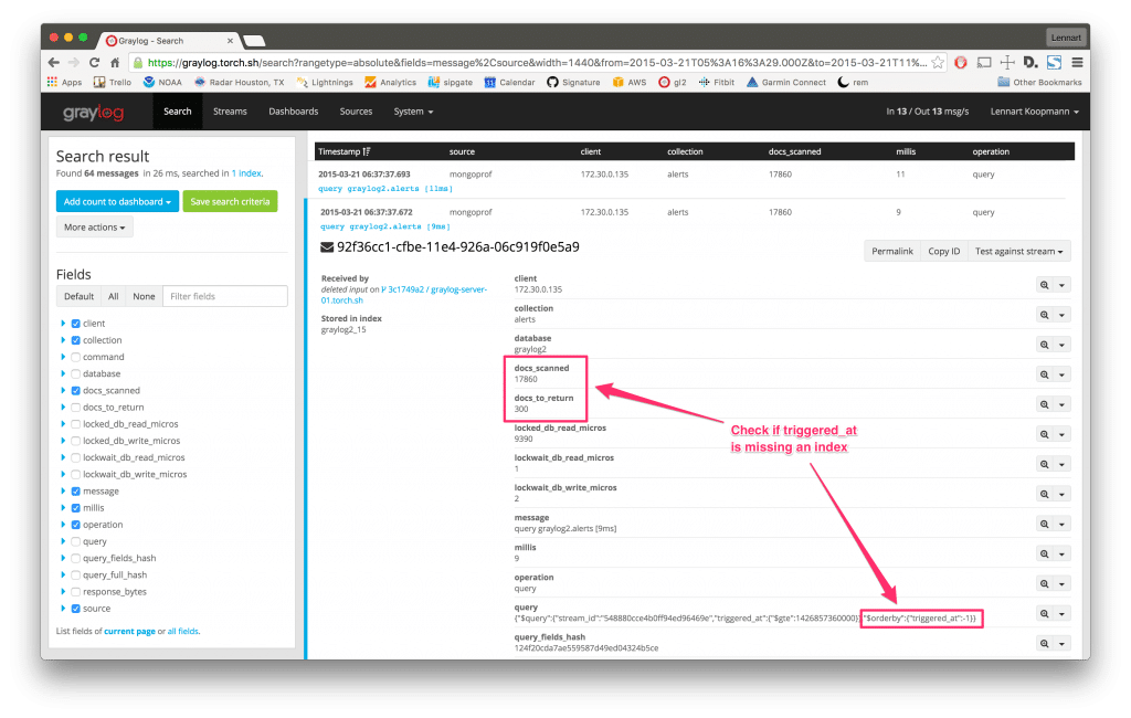

Digging deeper, I clicked on a row in the Messages table to expand more detail:
It turns out that 17,860 documents had to be scanned to fulfill the request of a 300 document result set. We see that the query requested 300 documents sorted by the field triggered_at. It appears that the field is not indexed, meaning that MongoDB had to load all documents into memory and manually sort the entire document set.

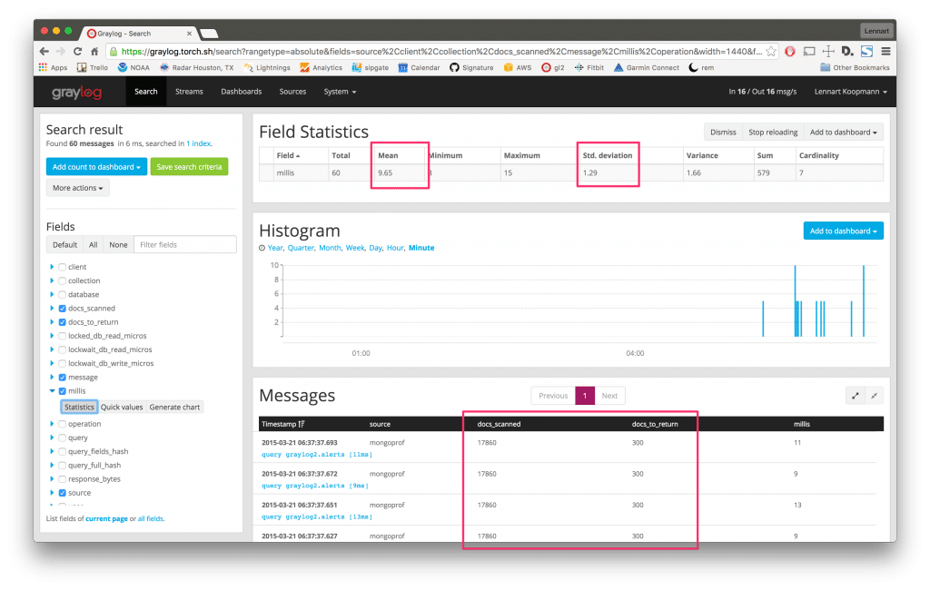

With Graylog, you can analyze whether a single slow query is always slow, or if it’s an outlier caused by other factors. Remember the slow queries we found in the example above? Let’s dig deeper into one of the queries by narrowing down the search result to only a specific type of query using the queryfieldshash field:
Now all search results and analysis methods are only applying to a single type of query. By analyzing the field millis we can see that the mean calculation time is 9.65ms and the stddev is not very high, indicating that this query is indeed always slow. The search result table is indicating the same. The histogram shows you when exactly this type of query has been executed.
