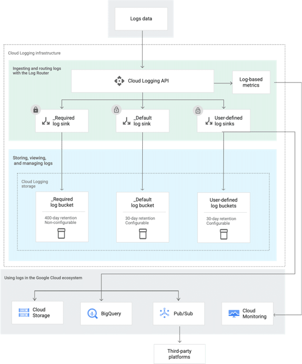

Routing is the process of getting logs from point A to point B. When talking about logging in Google Cloud there is a process for routing logs to not just custom log buckets but other destinations such as Pub/Sub topics, BigQuery datasets or Cloud Storage buckets. This process uses a concept of sinks, sinks essentially act as routers for the logs, they work independently of each other (so no rule conflicts) and can use inclusion or exclusion filters to filter which logs get processed and sent to a destination.
This logging process is visualized in the below image provided in the Google documentation (https://cloud.google.com/logging/docs/routing/overview)
Google Cloud Log Flow Diagram
Making Sense of the GCP Log Flows
To summarize with this additional context, Google Cloud stores logs in log buckets within the cloud logging service. By default, all logs are routed to one of two buckets and that specific logs can be routed to additional destinations outside of the logging service such as Pub/Sub topics, BigQuery datasets or Cloud Storage buckets using sinks.

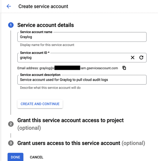

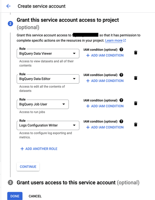

We need to first create a service account (https://cloud.google.com/iam/docs/creating-managing-service-accounts) which the input will use. If you are unfamiliar with GCP this can be done in the IAM & Admin section where Service Accounts is a section and there is a Create Service Account button which will launch a creation wizard.
Create Name and Description
In this wizard simply give the account a name and description.
Permissions

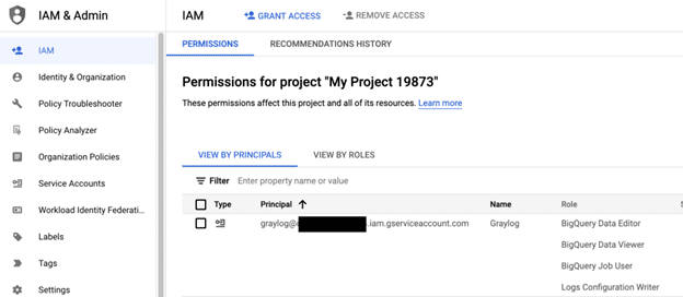

Assign it with these permissions:
  • BigQuery Data Viewer
  • BigQuery Data Editor
  • BigQuery Jobs User
  • Logs Configuration Writer
You can now select done and verify the permissions of the account within the IAM section.

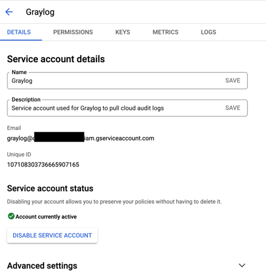

Generate a Key File For Graylog
We need to generate a key file for Graylog, go back to the service accounts section and click on the new service account which will take you to the account details panel, now is a good time to write down the unique ID of the account as you will need this for the input creation in Graylog.

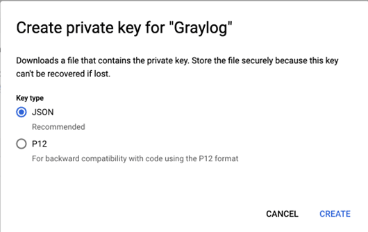

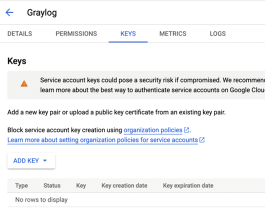

Add a new key
Go to the KEYS tab and add a new key.
Create JSON Key
Create a new JSON Key file and store it somewhere safe.
Store the Key

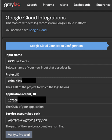

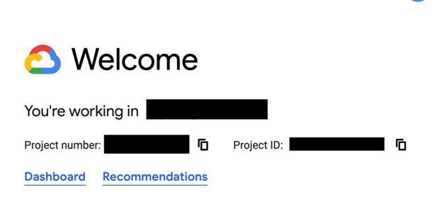

Note the Project-ID
Before you do anything though, you need one last key bit of information from your GCP console. You need the project-id. You can find this on the homepage of the console (you can access this by clicking the Google Cloud icon in the top left) it is the Project ID value you require not the project number. Add this value to your note with the service account unique ID you noted down earlier.

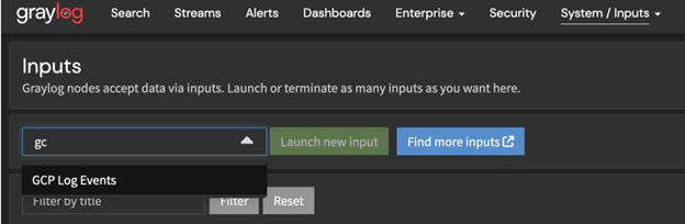

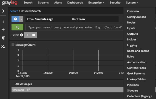

We are now ready to deploy and start our input in Graylog. We need to navigate to the inputs page, users utilizing forwarders will need to go to the input profile assigned to their forwarder to do this.
The inputs page can be found in the System menu. The forwarders can be found in the Enterprise menu.
You will want to launch a new GCP Log Events Input.

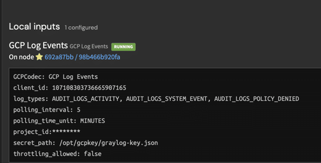

Now you will need the details you noted earlier, I’ve left part of this image un-obfuscated. This is to just demonstrate that the project ID is, not the project number and that the application ID is the unique ID of the service account you noted down. The path provided must be the absolute path to the key file.

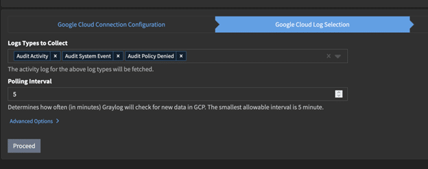

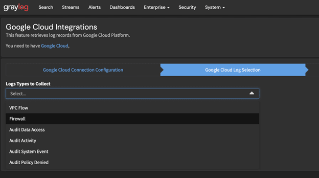

Select the Logs You Want
Next, you need to select the logs you wish to collect. Remember we explained include and exclude filters earlier? The values you choose in this selection will become include filters on the log sink within GCP.
This page also allows you to set the polling interval, or how often Graylog will check for new messages to collect. This cannot be any lower than 5 minutes.

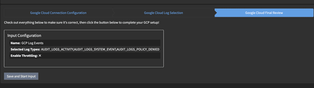

You now get a confirmation dialogue. If you are happy then you can go ahead and save and start the input.
If all was set up correctly, up to this point, you should see the input running.

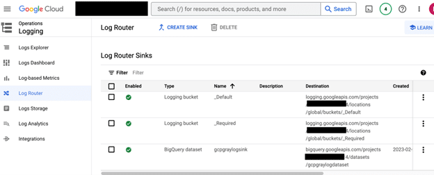

Ok so we haven’t quite finished yet, we need to jump back into GCP to do a bit of final configuration to make this work.

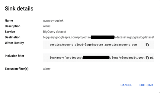

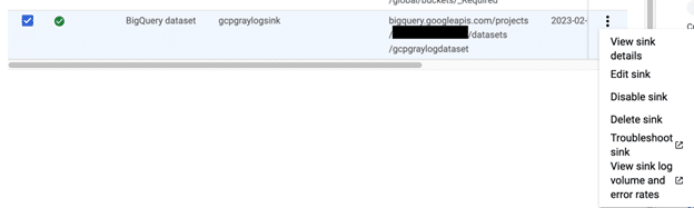

Back in the GCP console you should navigate to Logging>Log Router where you will see the log sinks for the organization. The one we are interested in is the newly created “gcpgraylogsink”
Click on the ellipses on the right of the sink and choose view sink details.
You will notice that the writer identity is not that of the service account we created earlier. This is not editable. Copy the service account name which in this case would be: “[email protected]” the “serviceAccount:” part is just a prefix. You can also view the inclusion filters from here now if you would like.
Note: if the writer’s identity is “none” or blank you should not need to complete the next few steps

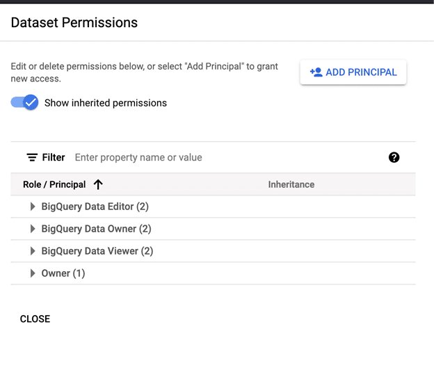

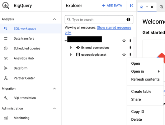

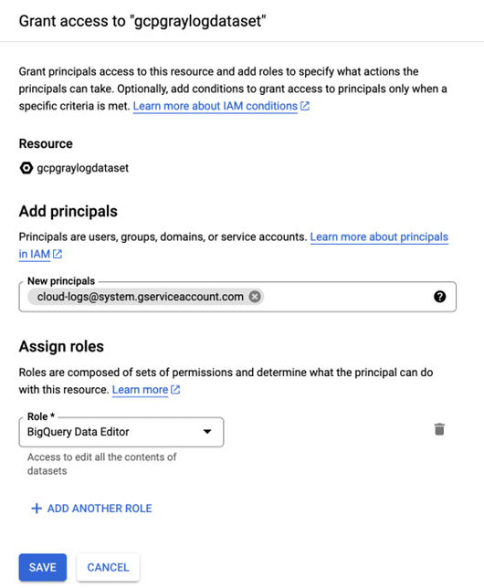

Now you need to go to the BigQuery SQL workspace within the console where you will see the “gcpgraylogdataset”. Notice there are no tables created? You should click on the ellipses to the right and then select the share option. We must assign the writer identity of the log sink to the dataset.
Select Add Principal.
Paste the writer identity into the principal and assign the BigQuery Data Editor role, save the change.

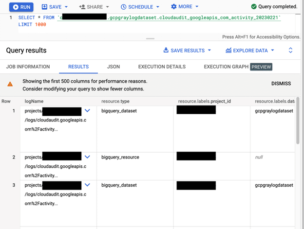

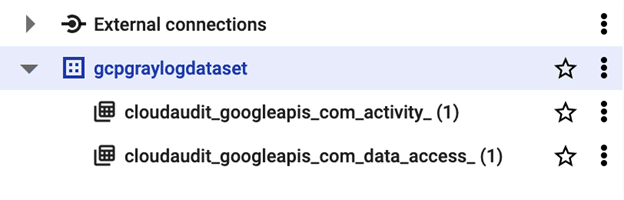

If you refresh the contents of the dataset, you will see new tables have been created.
You could even query these to verify new data is being written to the tables, for example:

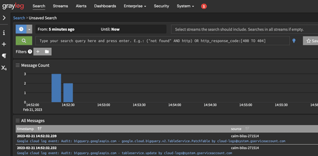

Congratulations!
You should now see your log events within Graylog.
And the events are even parsed for you.

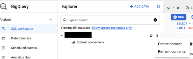

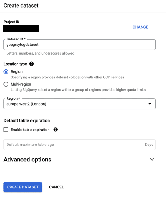

I mentioned this several times through this blog, but one thing the input does not do today is allow you to deploy the BigQuery Dataset in another region. You may remember that the input checks if the dataset exists or not as part of the process. We can leverage this to deploy the dataset ahead of time in our desired region and then allow the input to set up all the other parts. You can set up the whole thing manually if you desire and then only give the service account the BigQuery roles and not the log configuration writer.
So essentially if you want to deploy this in another region you can simply go to the BigQuery SQL editor and under your project, select Create dataset.
From here make sure the Dataset ID is “gcpgraylogdataset”.
Create the dataset and then the same steps as earlier are needed to add the writer identity as a data editor of the BigQuery dataset.
