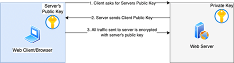

How web traffic is encrypted/decrypted
In order for TLS encryption to function, a web server, such as Graylog’s Web Interface, must be configured to use 2 different certificates:
  • Public Key
  • Private Key
When a client, such as a web browser, connects to a web server using TLS/HTTPS, the web server sends the client its public key. The client can then use this public key to encrypt any traffic sent to the web server. In order to decrypt this traffic, the corresponding private key must be used. Only the web server has access to this private key.

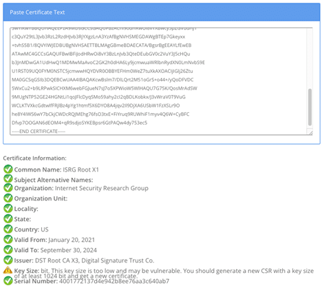

You can use a Certificate Decoder tool, such as https://www.sslshopper.com/certificate-decoder.html , to validate the certificate.
You can only paste a single certificate into the text box for the above link.
Example output:
