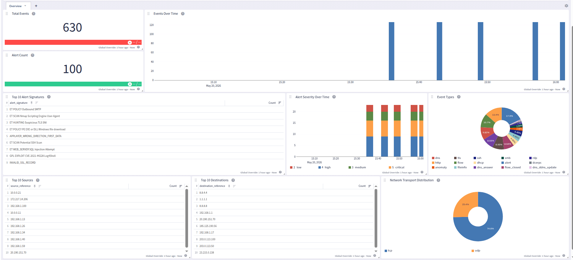

Suricata Overview Dashboard
Graylog Enterprise and Security
With Graylog Enterprise and Security, your team gains structured visibility into one of the richest network telemetry sources available with your IDS/IPS. The Suricata IDS/IPS Content Pack turns raw EVE JSON events into searchable, correlated, GIM-tagged data that flows directly into your threat detection, alerting, and investigation workflows. For more on this integration, please follow the documentation.
