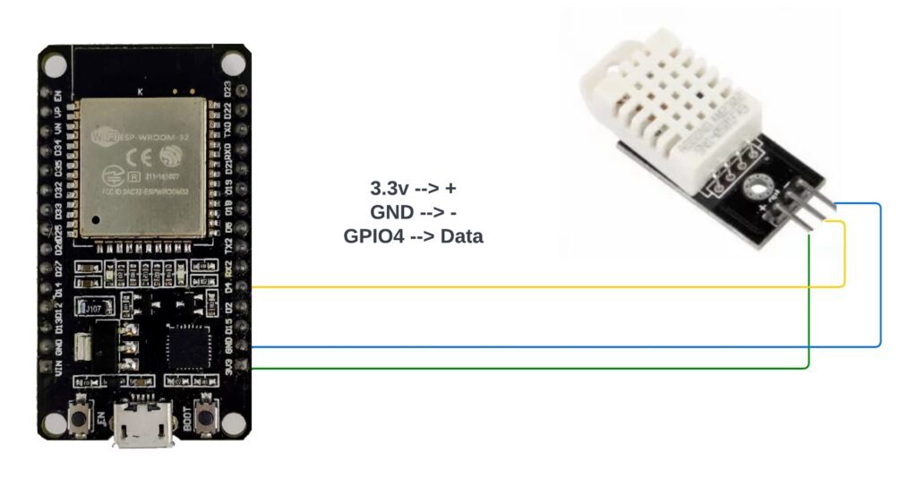

The DHT22 data pin is connected to GPIO4. Power comes from the ESP32’s 3.3V rail.
DHT22 Temp Humidity sensor
Wiring It Up
Wiring it Up

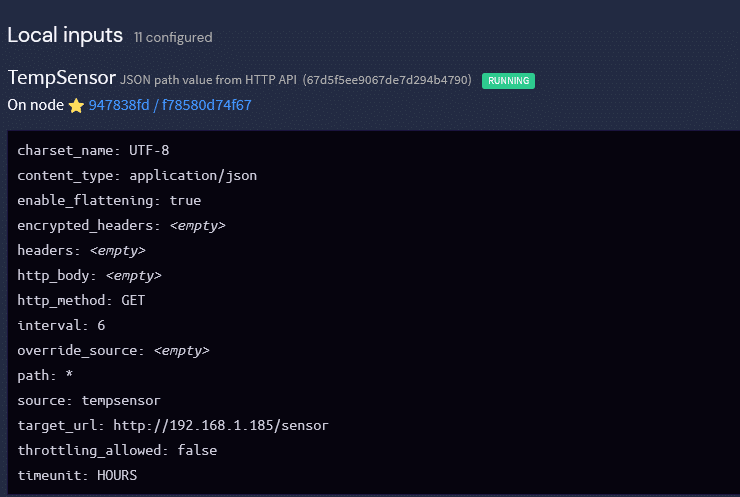

To get this data into Graylog, I set up an HTTP API input. This input type is perfect for ingesting structured JSON from IoT devices or scripts. Note: I did not setup advanced token security or any other more secure setup. This could include an API key in your Arduino setup.  This was for basic use and always for best practice, secure your stuff.
Temp Input Screenshot
Here’s the approach:
  • The ESP32 code doesn’t push data—it just serves it in this case.
  • I scheduled the input to poll every 6 hours
  • It hits the /sensor endpoint, and then pulls the data to Graylog.

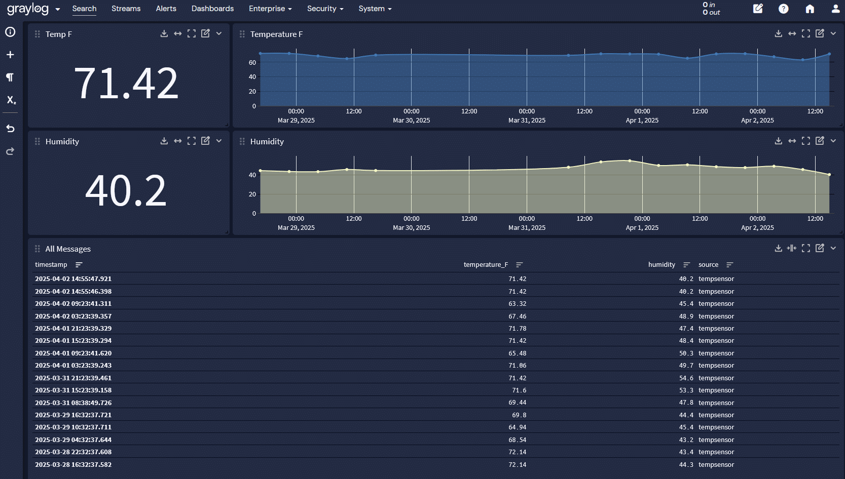

Once the data is flowing in, it’s easy to build a dashboard that gives you a real-time view of your environment. I created widgets to show temperature and humidity over time, and also added gauges for current values.
If you want to get creative, you can even trigger alerts for thresholds—like if the humidity spikes or the temp drops below safe levels for a server rack or in my case, the guitar room 🙂
Temperature Dashboard
