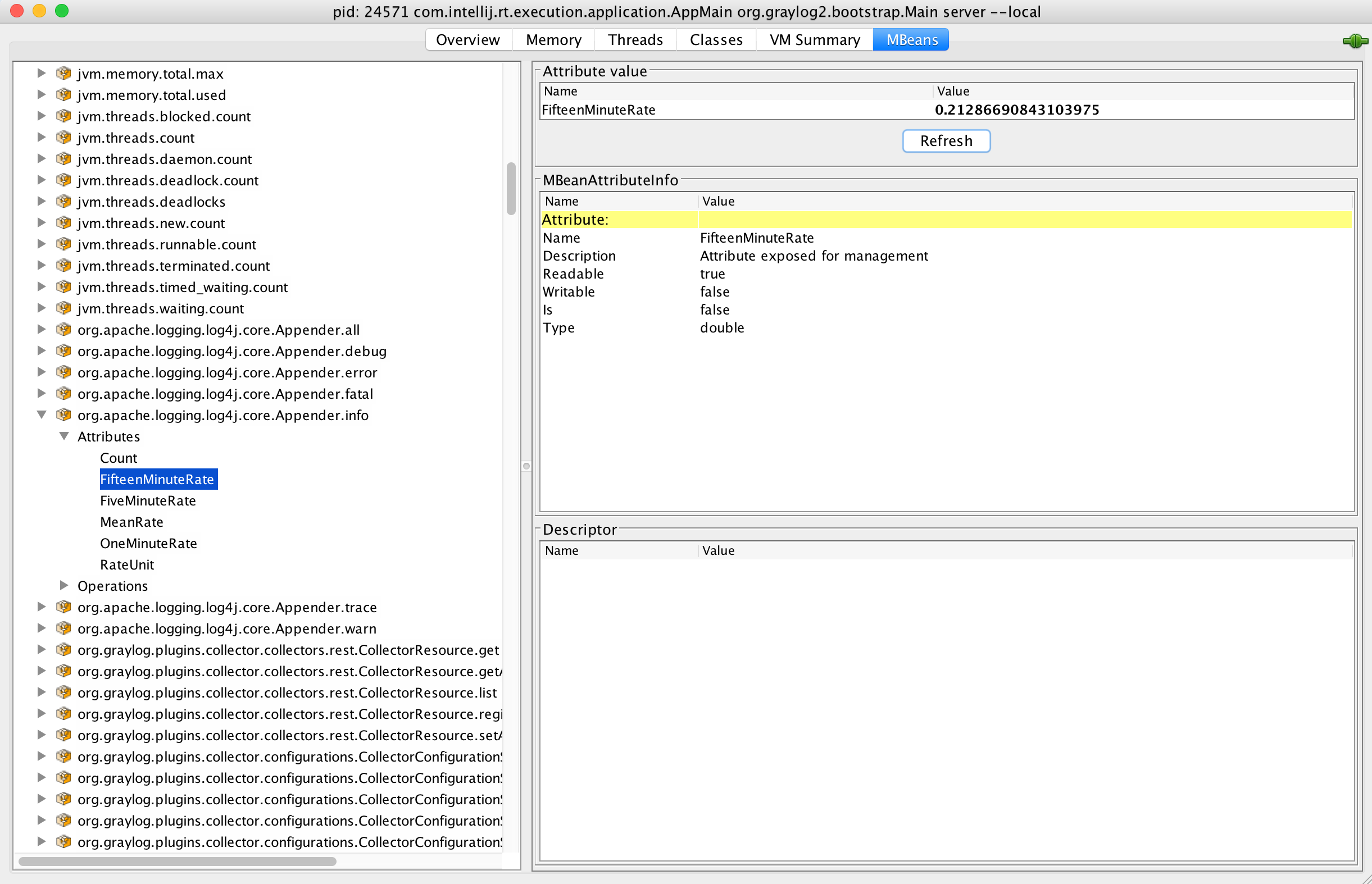

Accessing the metrics through JMX
Graylog also exposes all internal metrics through JMX. Many monitoring tools support this and it’s a very viable option to choose, especially if you are already monitoring other Java applications in your environment.
Java Management Extensions
