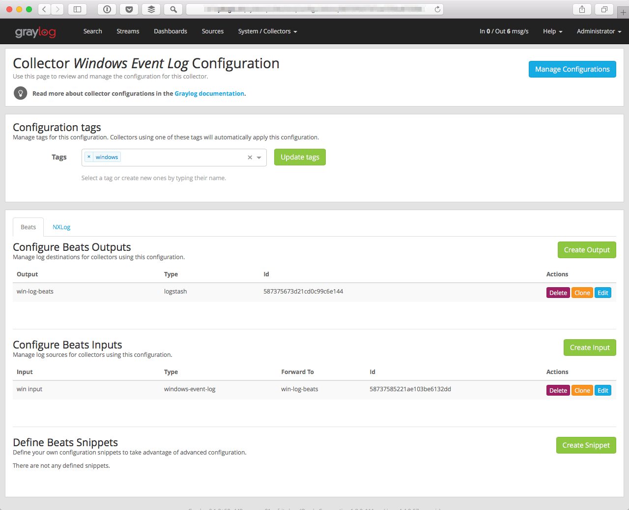

Follow the step-by-step guide to create a configuration and choose WinlLogBeat for the type of configuration.
The important step is to now replace the Event name with [{‘name’:’Microsoft-Windows-Sysmon/Operational’}] so that you will only receive the sysmon messages in Graylog.
With this setup, each windows host that runs sysmon and has the collector sidecar configured with the tag windows will send over messages.

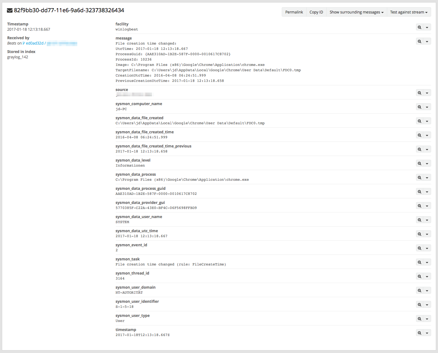

Your messages will now look like the following:

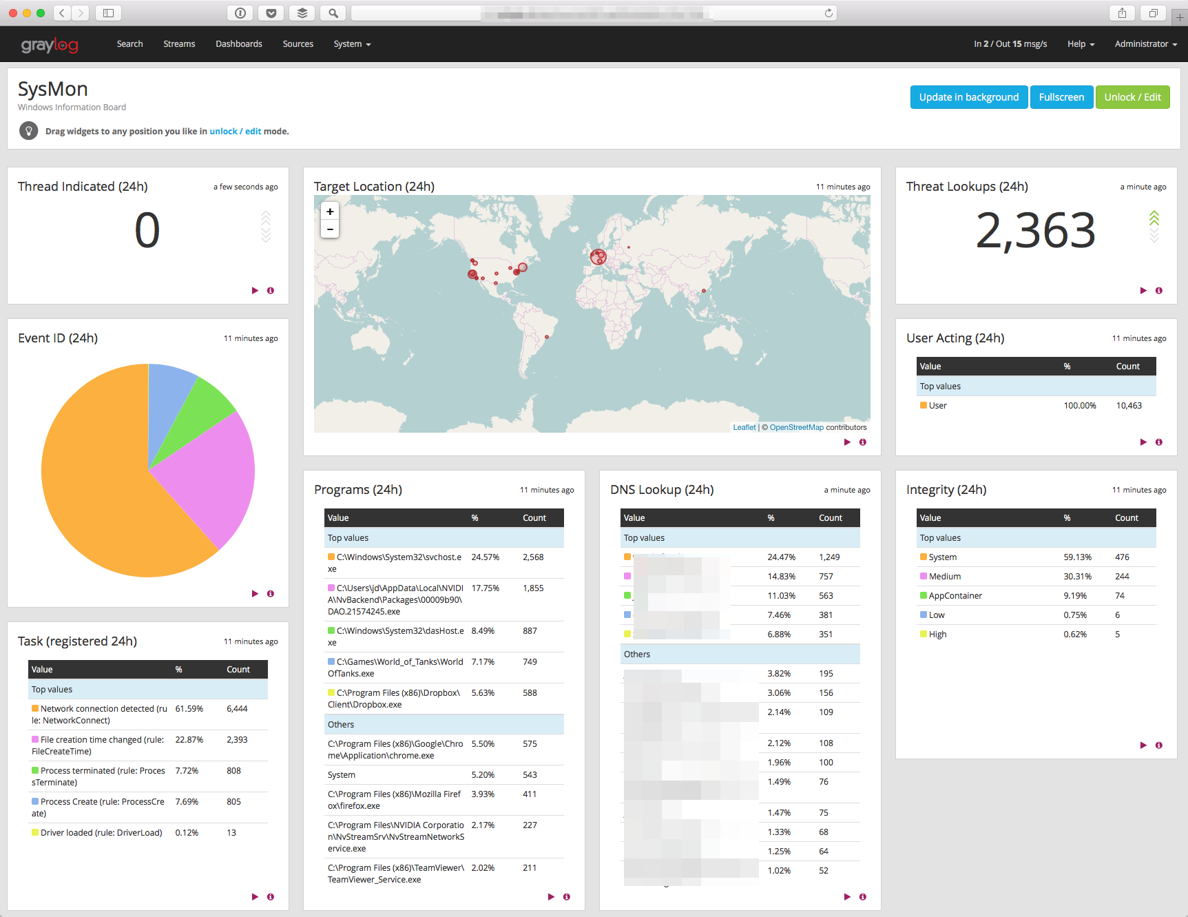

Create Dashboard
To easily view and work with the data, you can create your own dashboard or download the dashboard below,

With the verbose information from sysmon, you will be able to create user profiles and discover which programs run on Windows system. The benefit of having this data in a central environment is that you can see correlations, work with the data from all machines you are responsible for, as well as run a certain task once, and not on multiple systems.
This should also be viewed as a starting point for your journey as we’ve only covered the basic lookups in our Dashboard. You can also use the search _exists_:sysmon_cmd_hash to quickly look for the process hashes that were created on the Windows Systems.
