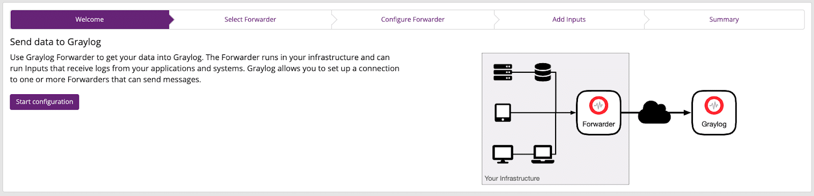

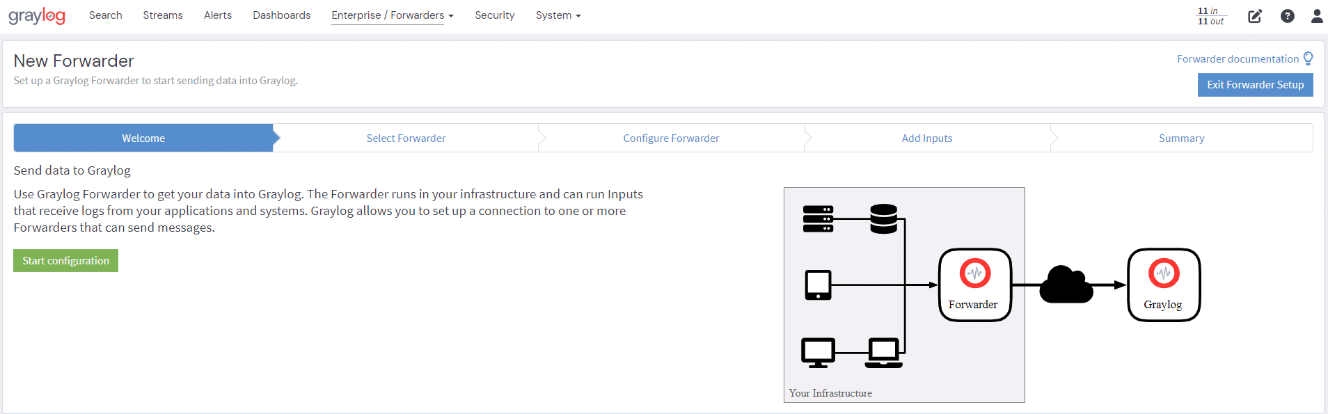

You can easily set up your Graylog Forwarder using our Wizard Interface.
You can use our Wizard Menu for configuring your Forwarder, or you can create a customized configuration.

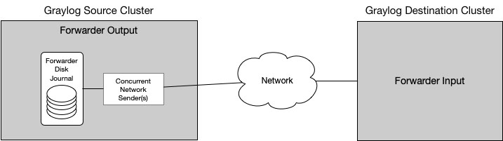

The Graylog forwarder is capable of sending logs at very high throughput rates. These can be affected by things like CPU Clock Speed, CPU Cores, available memory, and network bandwidth. There are also many configuration options to help with any network.
If you are using Graylog Cloud and Cloud Forwarder’s disk journal, it caches data and sends the messages to Graylog Cloud in case of a network outage.

    The Forwarder uses HTTP/2 (gRPC) for transport. If using more than one Concurrent Network Sender, then load balancing is supported. For more information see Load Balancing gRPC.‍

  • Are there different set up for each environment? If you are setting up a Forwarder for Graylog on-premise, you will need to create a Forwarder input on the System > Inputs page. Skip this step if you are using Graylog Cloud.
