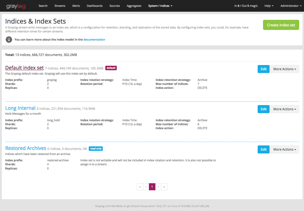

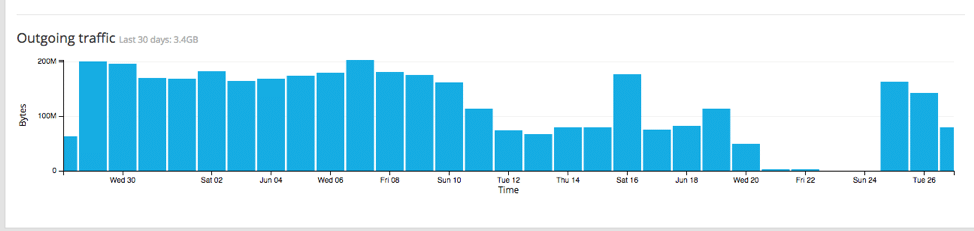

How long you can store your logs with Graylog depends on your ingest rate, the log size, and the available storage. When you already have Graylog up and running, you can see your ingest rate into storage in the overview.
The amount of space taken on your disks depends on your storage configuration. The storage space varies and is hard to calculate upfront, so Graylog displays the current used storage and the configuration in one place.
You can configure how long you want to store your messages, based on index sets. You can see the configuration settings in the documentation.

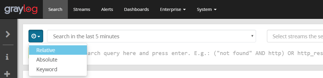

In Graylog, you have three options to select the timeframe of your search:
- Relative: from now into the past
- Absolute: a configurable time and date
- Keyword: text that conveys a timeframe, such as “last week”
The most commonly used search is the relative search. Typically, users search for data from the last X minutes/hours until now. However, when looking into historical data, the absolute search selecting specific dates is more important. You can also combine the two searches to search for the last seven days a year before and compare that to the relative search in the last seven days now. Having these two searches allows you to compare the near past with the historical data. This allows you to conduct a trend analysis over a broader period than just the last few days. You can look at specific timeframes or the entire previous year, depending on how long your system collects and keeps the log messages.
