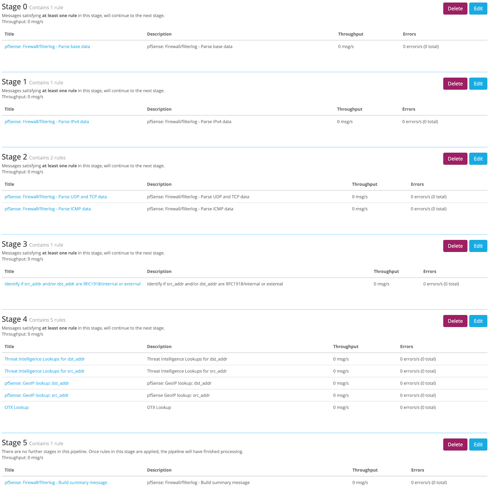

NORMALIZE AND PARSE THE DATA
To make your log data useful, you need to normalize the data with a single, comparable format. Then you can break apart the log message and do additional checks.
For example, you might want to create a dashboard around a source IP that shows up no matter what firewall version you’re using. You want to normalize that data when you bring it in. This lets you break the big log message into smaller, easy-to-read fields. In Graylog, you can do this through pipeline rules and enrichment.

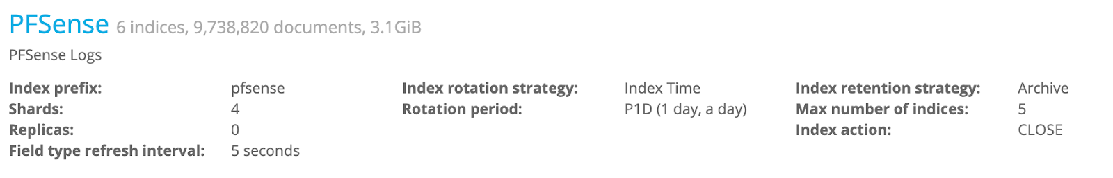

SET UP INDEXES
Generally, you only need to retain logs for 30 days. In some cases, compliance requirements might make that 90 days. In either case, you want to set the right indexing times so that you can keep the data for as long as you need it while not overwhelming your storage capacity.

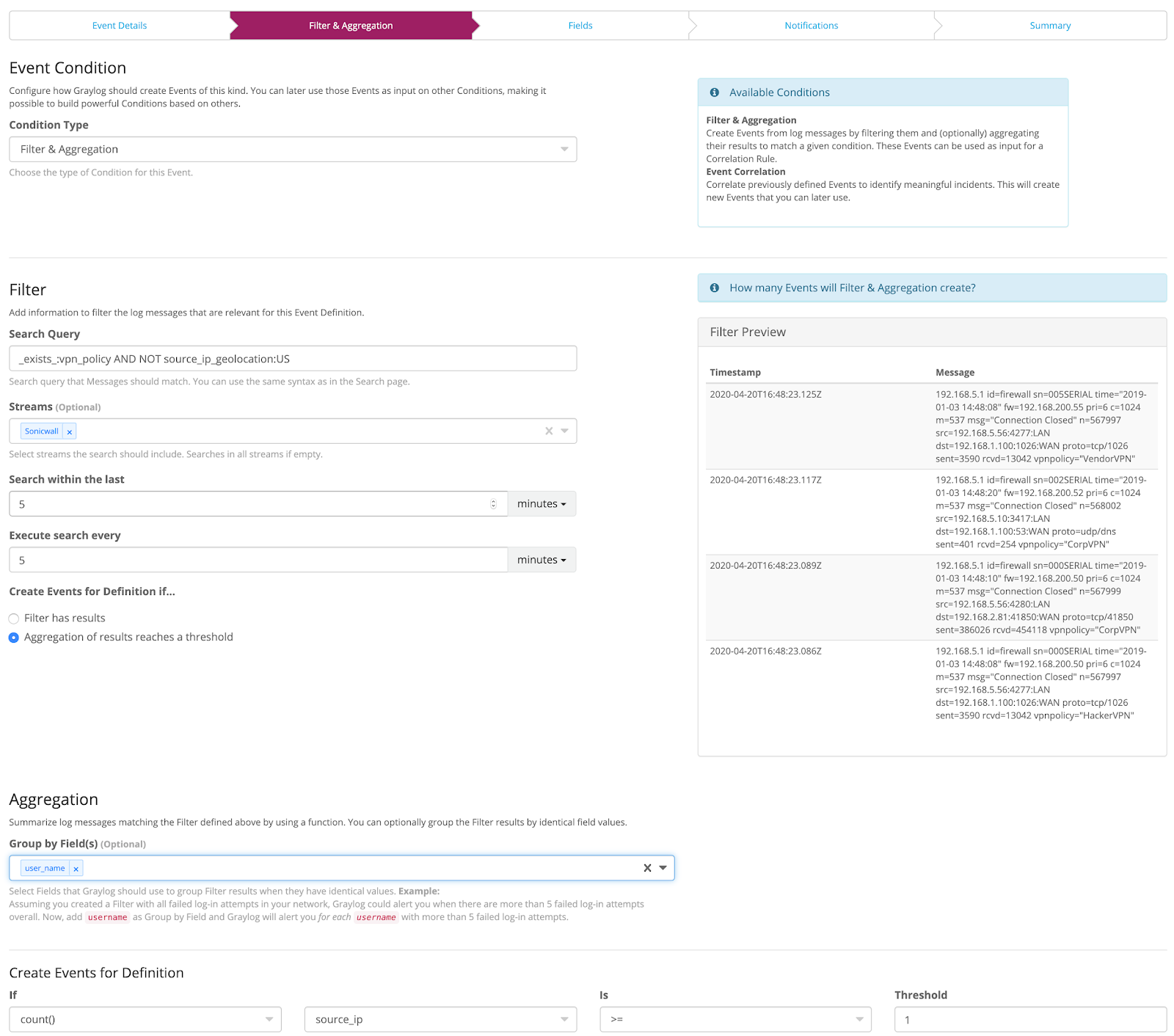

UNUSUAL LOGINS
Remote employees are at a higher risk for credential theft attacks. To detect potential security events in a remote or hybrid workforce, you need security logs and unusual logon alerts. Using highly targeted alerting rules will generally trigger fewer alerts, reduce alert fatigue, and prioritize risk. Unfortunately, to narrow the output, you can find yourself writing and maintaining many very complex alerts.
Graylog Logins Filter
For more efficient alerts, consider some of the following alerts:
  • Geolocation: based on country, or even by city
  • Time of day: based on outlier behaviors such as late afternoon or evening
  • Number of logins: setting baselines for excess numbers of logins per day or during a given timeframe
  • Multiple locations: tracking multiple account logins from different IP addresses

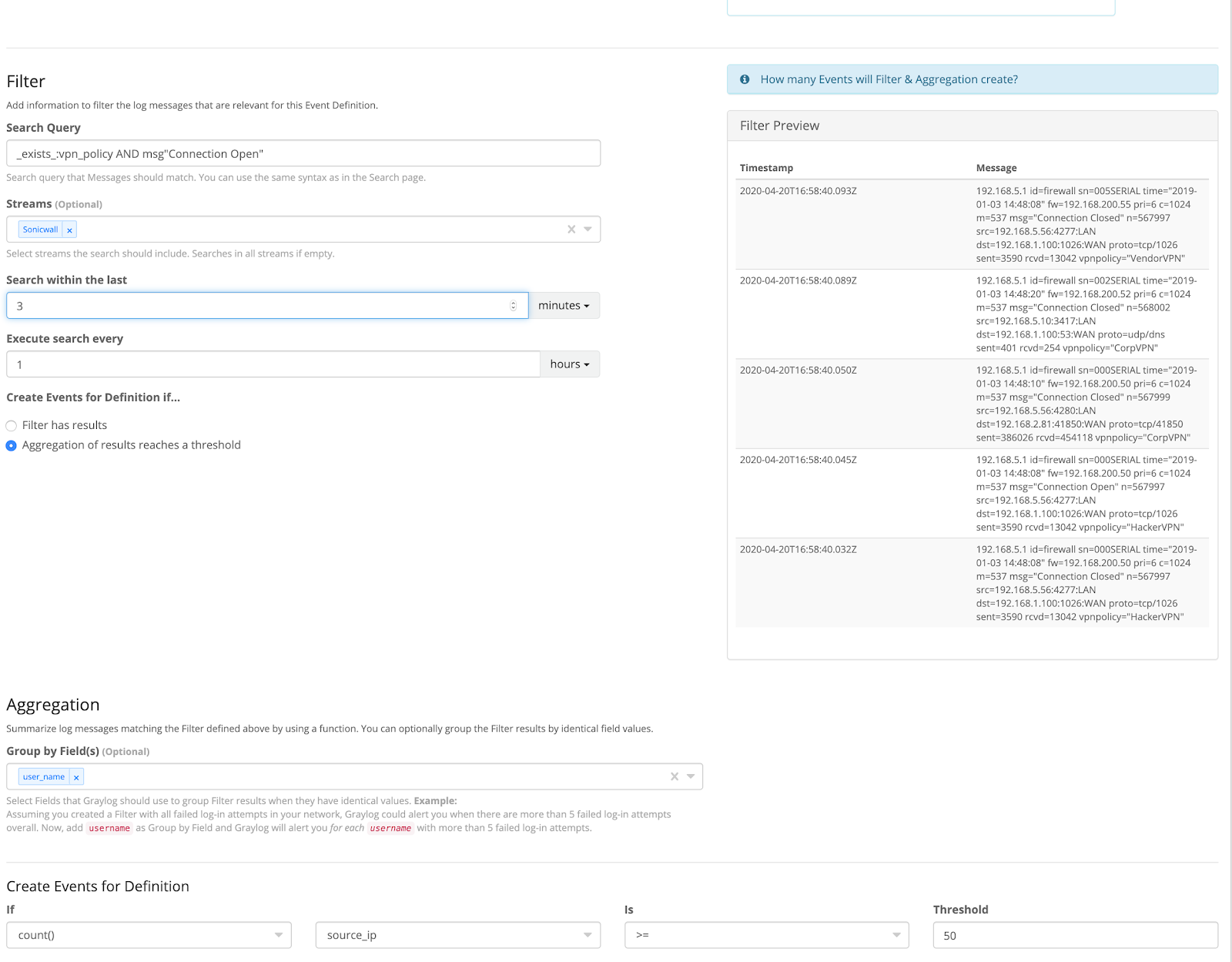

VPN licensing limits
With so many users logging in remotely, you need visibility into your VPN license usage, or employees won’t be able to do their jobs. Too many users VPNing into your network can make it seem like the firewall broke. In reality, you needed more licenses.
Graylog Licensing Limits Filter
With Graylog, you can capsule your VPN sessions coming in. You can run a rule every hour that collects logs based on the number of concurrent connections open in your firewall. You can use this to set a threshold limit that notifies you when you’re close to exceeding your number of licenses. For example, you could set the threshold at 90% that gives you visibility into employee network use and whether you need additional licenses.

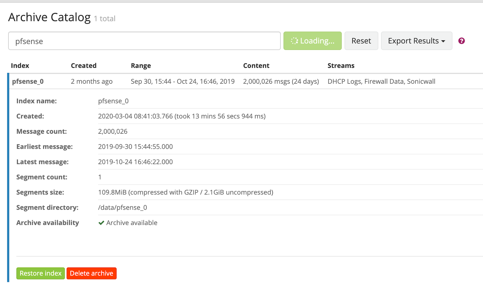

ARCHIVING
Organizations accelerated their digital transformation strategies an average of 6 years in 2020. IT teams struggled to keep businesses running more than anything else. As a result, many didn’t have the time to check their tools daily, including IPSs, firewalls, intrusion detection services, and different logging solutions.
Graylog Archive Catalog
Once everything settles, teams will need to go back and review this information. Graylog’s archiving makes it easier for teams to reimport logs to review them and look for the different patterns that show themselves. You can review your saved dataset with archiving, pulling logs back in, and running them through log analysis dashboards to see your irregular traffic patterns.
