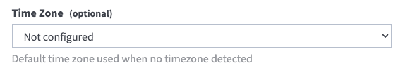

NOTE: Graylog 5.1 ads the ability to configure the timezone of Syslog inputs. This is a change in behavior where previous versions of graylog used the timezone of the server operating system where Graylog was installed and running.
You can configure the timezone of an existing syslog input via the inputs page (System / Inputs), finding the input, and choosing ‘Edit Input’ from the ‘More actions’ button. You can choose a timezone via the timezone select box at the bottom of the input configuration modal box:
Be sure to choose the timezone that matches the timezone of your log sources. For example, if your firewall is using Eastern Time (UTC-5), set the timezone of the syslog input to match.
