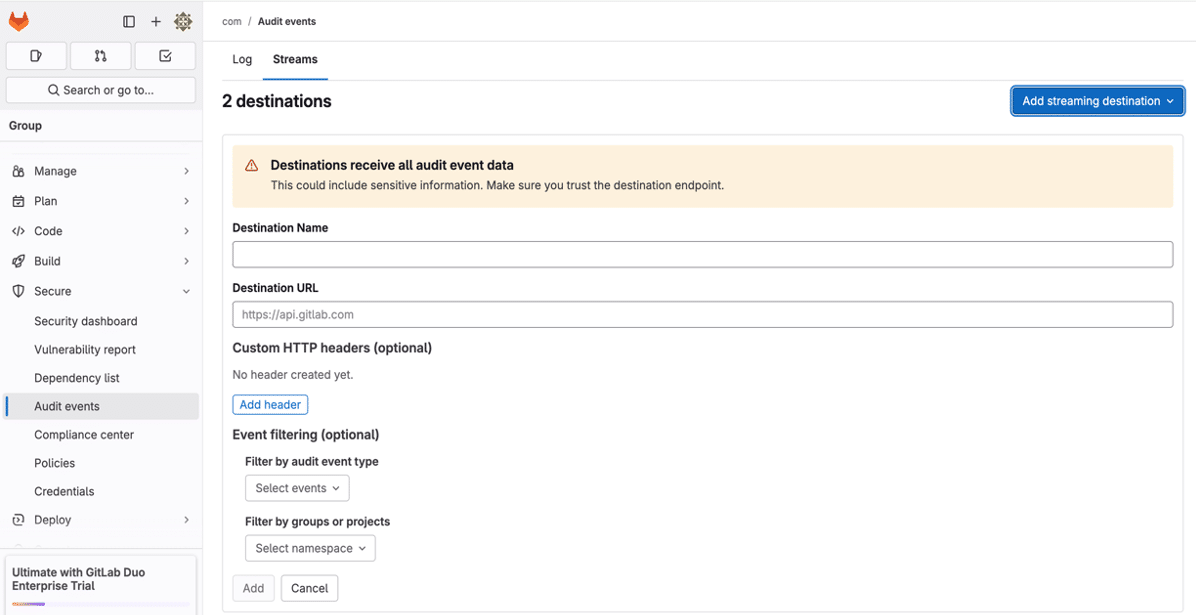

Start in GitLab:
  • Destination Name: Pick something recognizable like graylog-audit-stream.
  • Destination URL: Use the public-facing address for your Graylog Raw HTTP input—e.g., https://your-graylog-server.example.com/raw.
  • Custom Headers: Match the header name/value pair defined in your Graylog input config to help secure the stream.
  • (Optional) Event Filtering: Depending on your use case, you can control which types of audit events are sent.

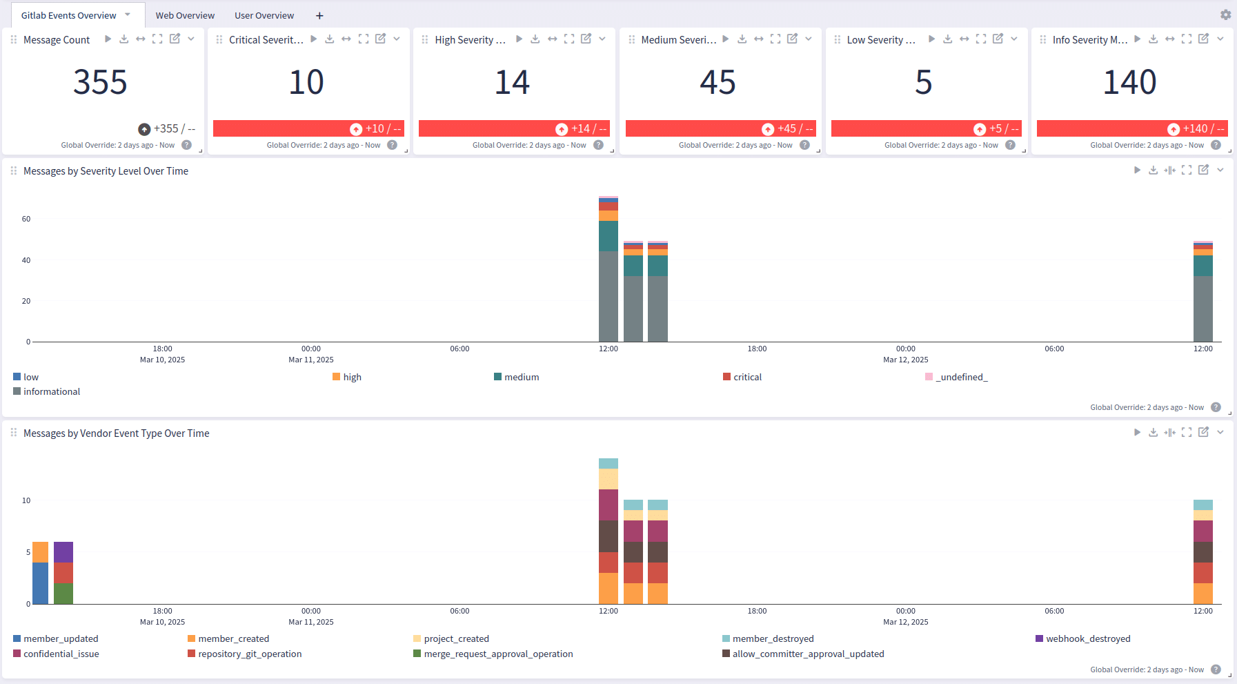

  • GitLab Events Overview – Events across your environment
Gitlab Events Overview Dashboard

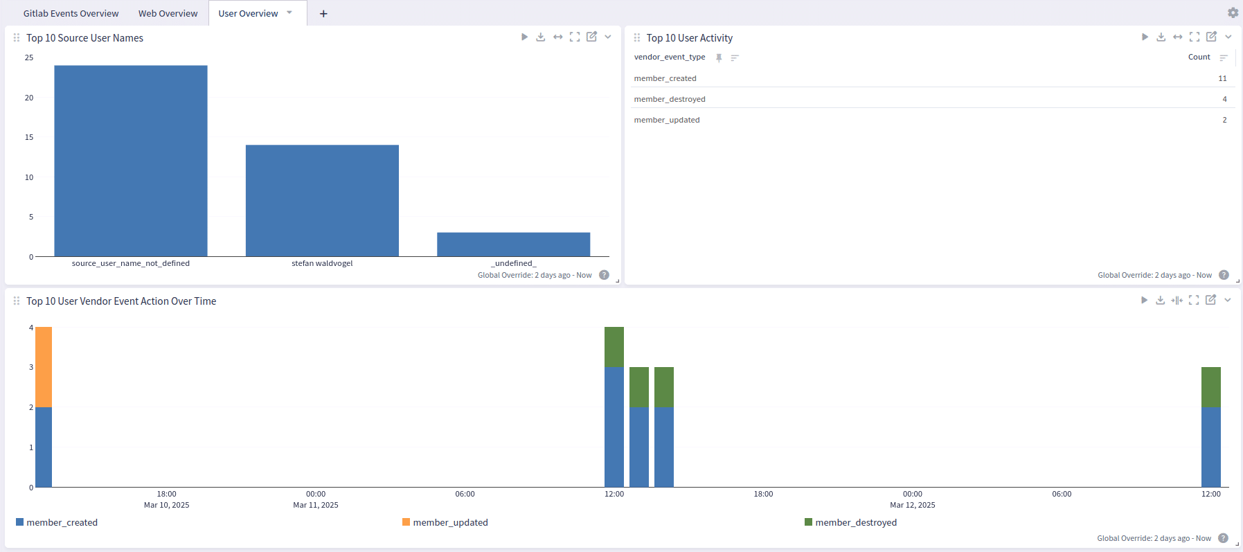

  • User Overview – Activity by user
Gitlab User Overview Dashboard

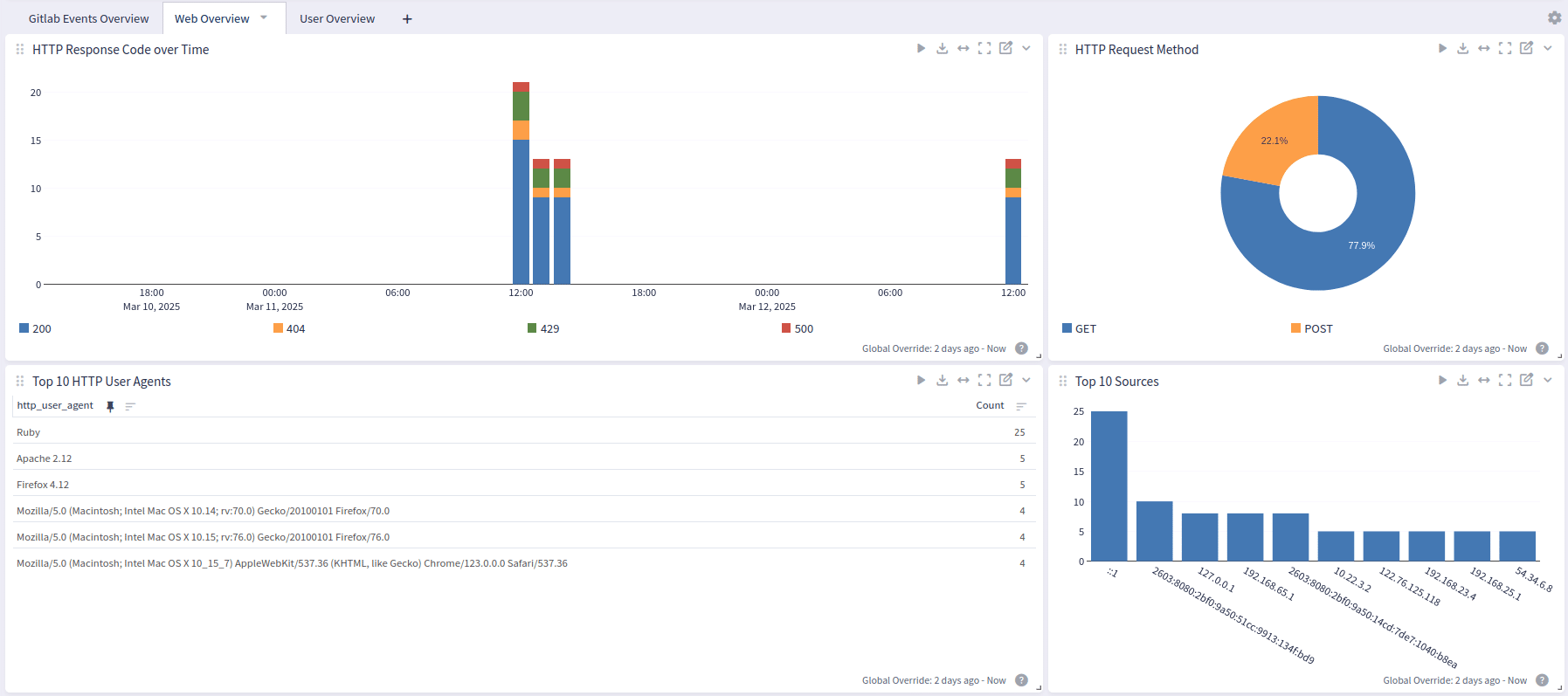

  • Web Overview – Web-based audit activity
Gitlab Web Overview Dashboard
